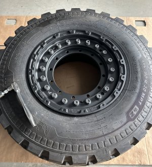

SORRY, Life got in the way for awhile. I had to have urgent back surgery right after mounting and getting the wheels balanced.
When they tell you, "paralyzed from the waist down" if you wait you kind of take it serious. I will be out of the tire moving business for the next 3 months. Had the surgery mid November.
A local tire shop did the balancing and I did the tire mounting, was EASY, at my shop. I mounted the front tires and all went well, then went to do the rears...WELL Hutchinson's with RAM adapter plates track 3/4" wider per side than stock or single piece wheels. WOULD NOT fit my subframe width. NO ONE mentioned the difference, and I never asked. You know what assuming does!
Called Mike at ADV Mobil and Justin Wehring (GREAT GUY). Found out I can run the RAM adapter plates on the outside of the assembly, approved by Hutchinson, so the tires clear the subframe. THAT took some time.
Justin also suggested running the FORD narrower adapter plates, which will make tire rotation a lot easier because all of the wheel assemblies will be the same. WAITING on a cost estimate for those parts. Mike at ADV has been very helpful and sold me the wheels at a very fair price, FYI. I have a test 5 mile run on the tires only. Like I said above down for 3 more months, bone growth.

Purcell (Bozeman) was able to get the Michelin X Force ZL's 10 days after they ordered them.
Interestingly enough Purcell said because the tires were "militarty tires" that Michelin required information on the purchaser before they would ship them. Kind of like a background check. Michelin only wanted owner's name, address and the make of the vehicle. They cashed the check so I guess I passed;)
Purcell did ask that I provide them with specific instructions on the torque sequencing and pattern needed to assemble the wheel.
That question, and what ive found so far, will be asked on my build thread. If there is any feedback that ide appreciate it.
The installation is scheduled for the last week of February.
