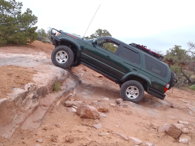

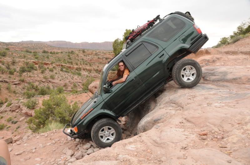

As for off roading it performs great. Mine has the rear locker, but I've only used it a couple times and that was for actual rock-crawling.

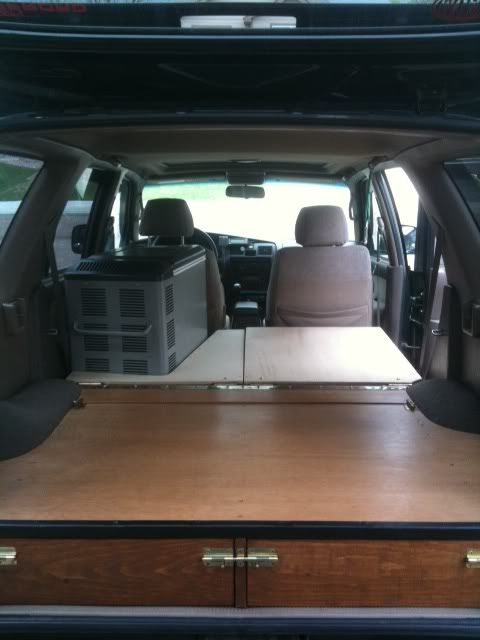

I really enjoy my 3rd gen 4runner. I have owned since mile one. Sure the 80 is bigger inside, but it is bigger outside too. It can be tight on trails. I do ExPo trips in my 4runner and rock crawling and it does well with both. I have a 45qt Engel fridge in it and still sleep two. It is a little tight but I sleep with my legs around the fridge.
Actually I would love to own an 80 but the gas mileage and lack of power turns me away.
