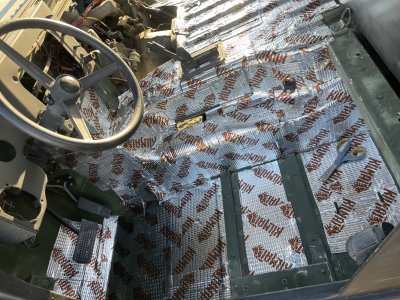

When the H-1 came out the civilians Ron B. contacted me to take and use it and make suggestions for them for the non-military use. The noise was big complaint that they got. Their solution was more sound deadening was pile on more insulation for the hump between the driver and front passenger foot well. This gave little foot room for the passenger.
