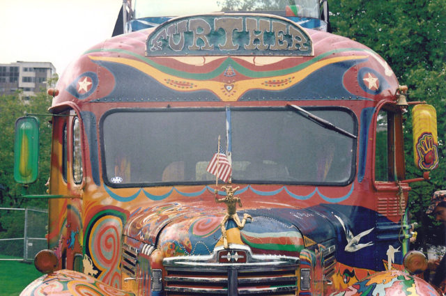

I keep thinking you need to put the name "Amelia" on the front where it used to say "Sunrader" - Sort of like the name on Ken Kesley's bus "Further"

Super happy with how it turned out. We will be adding back in a few more decals like the "4x4" and a "Bound.For.Nowhere". Also, thanks to a great suggestion here we are looking into getting "Amelia" painted by a friend who does pinstriping on the front panel.
