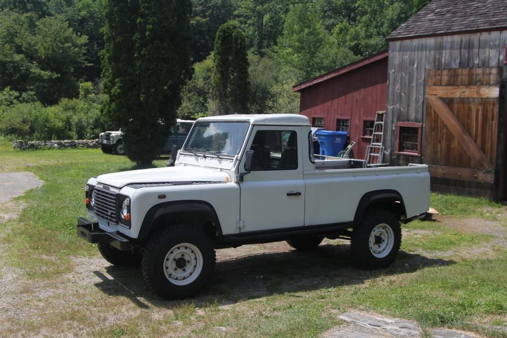

What I'm most looking for is what connects with where (more of an overall picture). There's an (I presume) large oil drain back under the turbo that is doing a terrible job of explaining where it needs to connect. As you showed, thank you, the oil pipes on the fuel side it actually added more confusion as to what that connection is for.

Have you got your photos?
I have got a discovery 2 TD5 and Disco 1 300TDi + Defender 300Tdi, if you need any other photos let me.
Plus the remains of a 300Tdi RR with an engine sitting in the chassis.
Cheers,
Graham

Not yet, but I'm sure he's working on it.
Thanks to both of you - I was starting to get bogged down on this project - your responses really helped.

Hope these help
superbuickguy
that is really helpful, thank you! I wish I'd seen the motor mount - for whatever reason the seller didn't send me the turbo side motor mount; so I simply copied the passenger side.... which is 3 1/2" wider than the driver's side... oh well, it's pretty easy to shrink metal - but hard to stretch it.

Should be 572312....don't hold me to it
I think those are the ones he used on the radiator mount - and the ones I have and am trying to use. On my build the intercooler seems to really want a different style as it is ever so much shorter than the radiator. I have Allisport stuff for reference.
