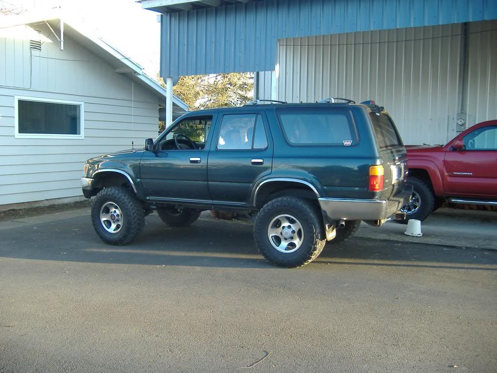

1994 4runner stock with about 180k, R150, and 4.30 gears. It was in great shape and was a great starting point for a build.
Stock
after about 3 months, I ordered ball joint spacers, Downey torsion bars, Downey rear 3" springs, and skyjacker shocks, and 33" BFG mud's

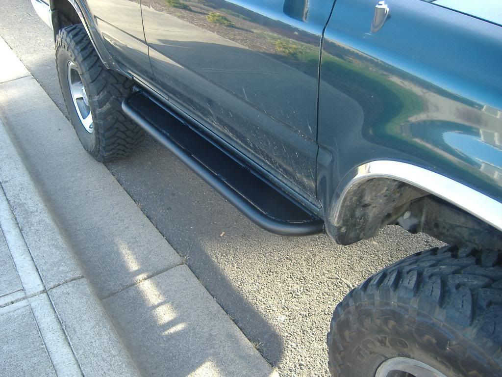

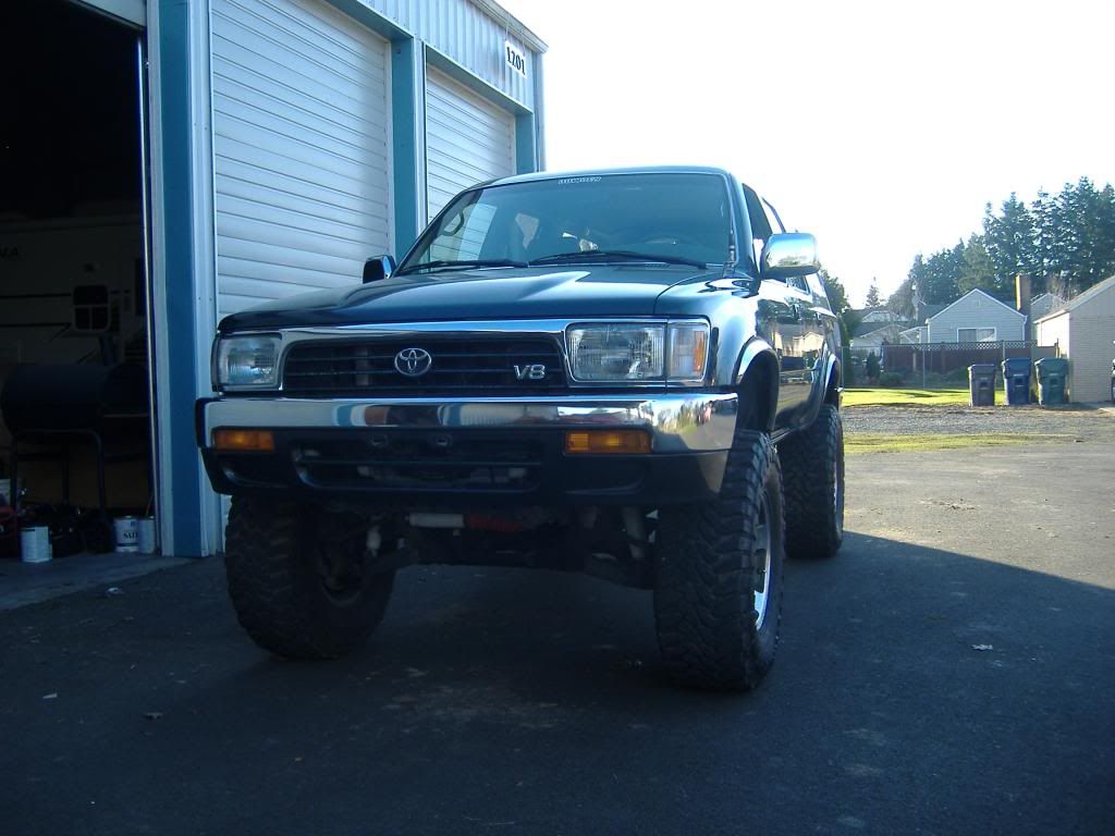

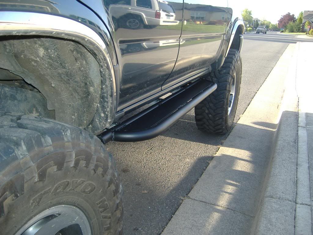

Swap was done for a while. I opened a shop customizing parts for people for the 1uz swap. I also started bending pipe and making sliders, roof baskets, ect. This was my first set of sliders I built and they were for me.

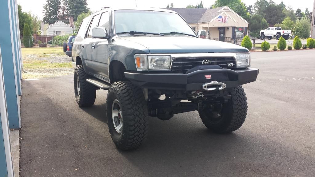

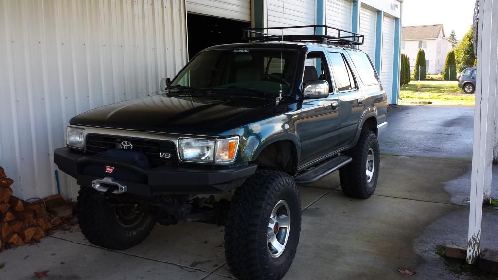

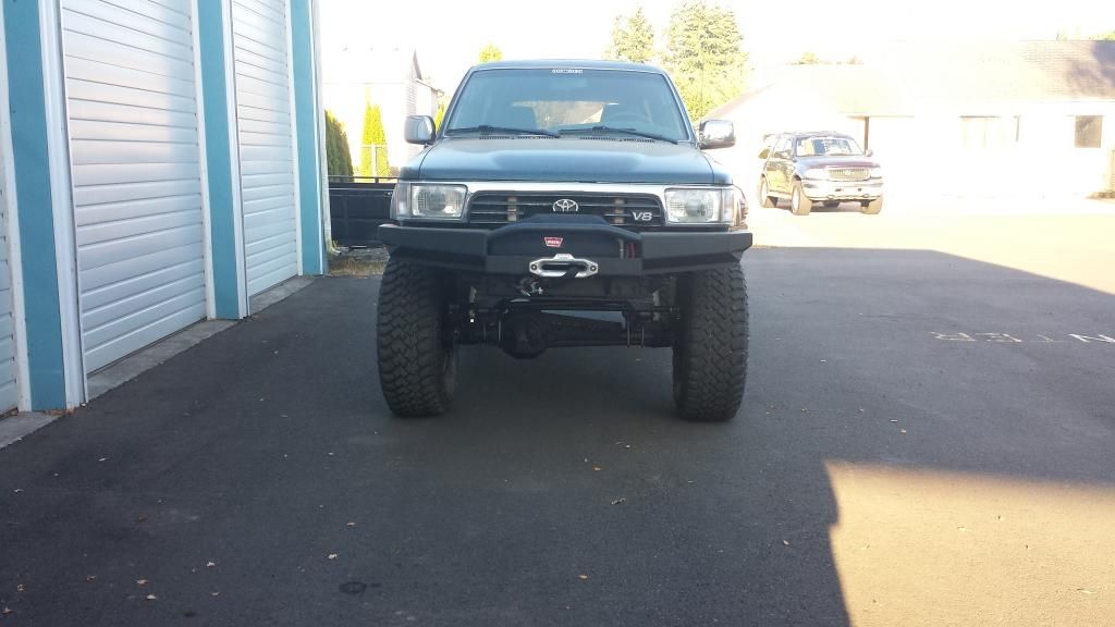

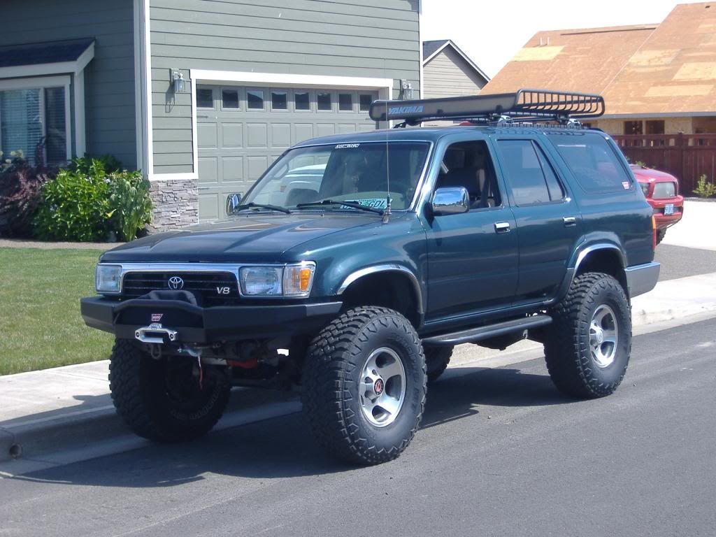

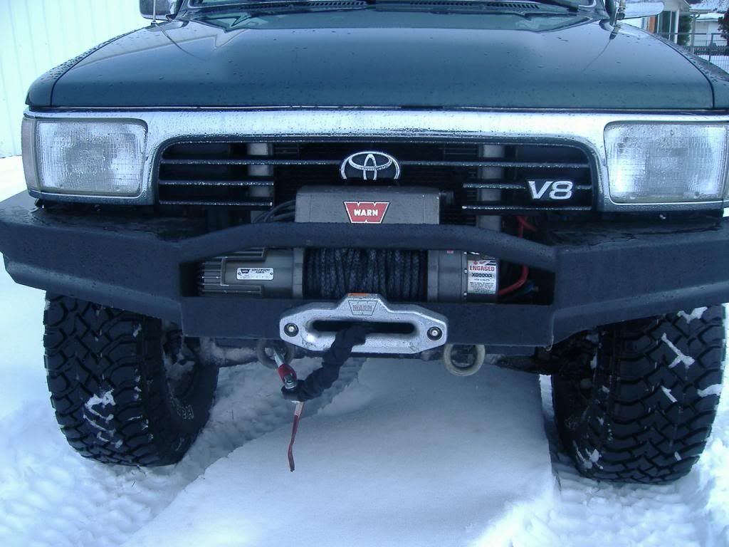

Decided I wanted a winch bumper. Decided to become a vendor for Sky Manufacturing. I bought there winch bumper and modified it. I also got a deal on a roof basket but didn't like it so that was short lived.

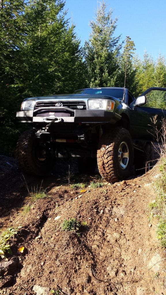

Last pic before the SAS began.

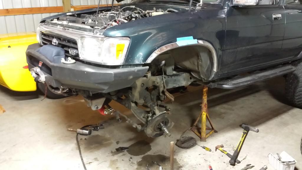

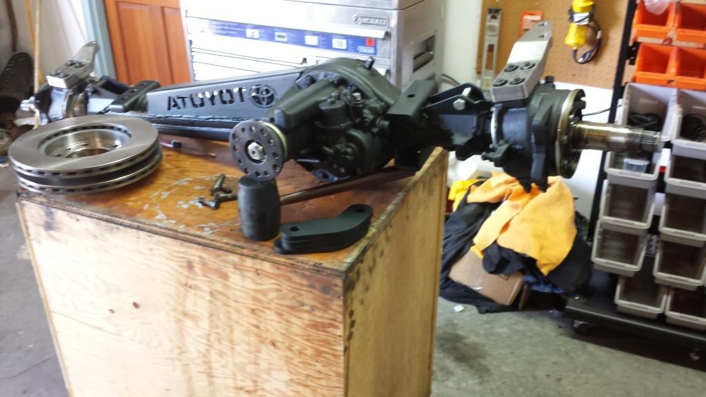

SAS begins.

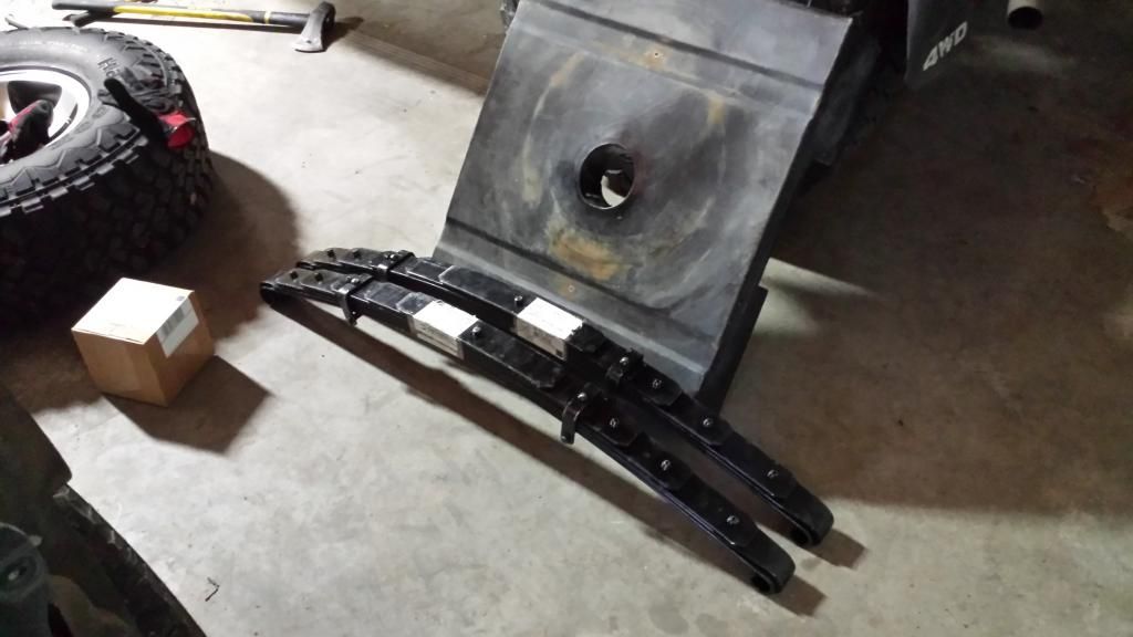

I went with a 1985 front axle. I am using the Sky wide axle kit, LC62 front rotors, IFS calipers, Longfield hub gears, longfield 27 spline axle shafts, FZJ80 front Elocker with Yukon 4.88 gears. I am using Off Road Solutions double elocker wiring harness. I am using custom built 3" leaf springs for the front, Sky low pro front cross member and sky boomerang shackles.

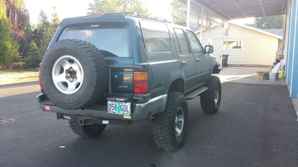

Hilux rear tire carrier ID tag

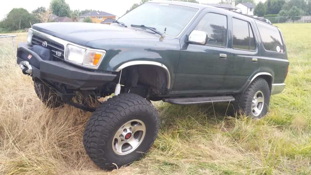

More pics

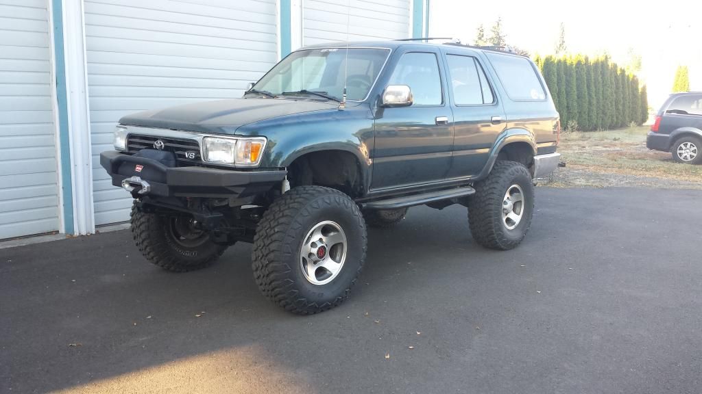

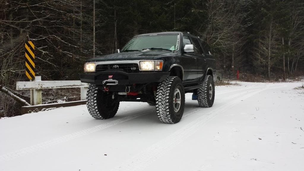

So all said and done here's the current list
201,000 miles on the rig, 121,000 miles on a 1994 Lexus LS400 1uz engine, R150 5 speed with adaptor, marlin crawler heavy duty clutch, NWT Custom flywheel, combination of Toyota 3.0 and 3.4 clutch parts, elocker with Yukon 4.88 gears, front FZJ80 hp elocker with Yukon 4.88 gears, built 85 front axle with sky cross over steering, sky wide axle kit, custom 3" springs, Off road solutions double wiring kit, NWT sliders, NWT roof basket, 315x75x16 Geolander MT's on FZJ80 limited 16x8 wheels and FZJ80 spare.... More to come
