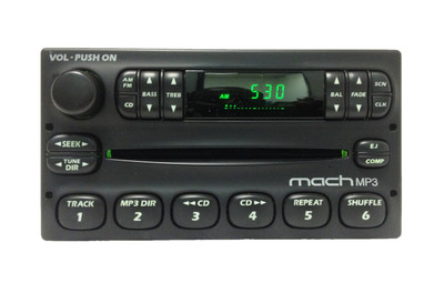

Many years back I made a conversion harness to connect a 2004 Stereo like the one above to work i my 1997 E350. It mounts perfectly without any modifications. The plugs are different, and that's why I ordered a plug to plug into the back of this Stereo, and a harness to connect an aftermarket harness into my 1997.
Anyway, when I installed it, it worked great. I'd used western union splices and taped all the joints with splicing tape that bonds permanently to itself. Recently, I found that the stereo was cutting in and out and the time was resetting till noon.
So I cut up a steel coat hanger to make the equivalent U shaped tools to remove the stereo from the dash. I then redid all of the western union splices and soldered the splices this time. After reinstalling the Stereo and going for a drive... no more cutting out, clock resetting after it looses the time, and the volume doesn't change. :D
Western union splices are one of the tidiest splices, and usually work great when done well (even without solder). I'm not sure if there was an open circuit or a short between two wires... but redoing all the connections resolved the problems.
I know that a lot of people put in aftermarket stereos, but I chose to replace the 5 watt AM/FM radio that barely worked. The newer radio will play CDs, MP3s, and also has higher output and better sound quality (as opposed to the cheapest AM/FM radio Ford had). I like that it doesn't stand out, but works well.

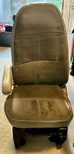

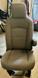

Been on the lookout for some new front seats. Our market here is very limited... in more than 10 years the only "good" seats that I found for sale locally were in worse condition than the ones I was replacing.
A couple years back I had a lead on some in Vancouver while I was there, but it didn't work out because they weren't as advertised, and the whole deal was sketchy as can be. This last weekend my perseverance paid off... I found a pair that the seller claimed were perfect.
Well they were super dirty but in decent condition. a bit of foam break down on the drivers seat that I've now repaired.
As they looked when I picked them up...
The picture doesn't show half of the dirt and grime. 14 years and 60k miles in a service truck without cleaning once (I strongly suspect).
They are still damp, and I'll likely run the upholstery cleaner over them again, but they are so much cleaner now. I'd like them to be clean enough that the water in the machine isn't the colour of dark chocolate. I'm not sure if they'll be clean enough that the water will come out looking clean... but we'll see.
