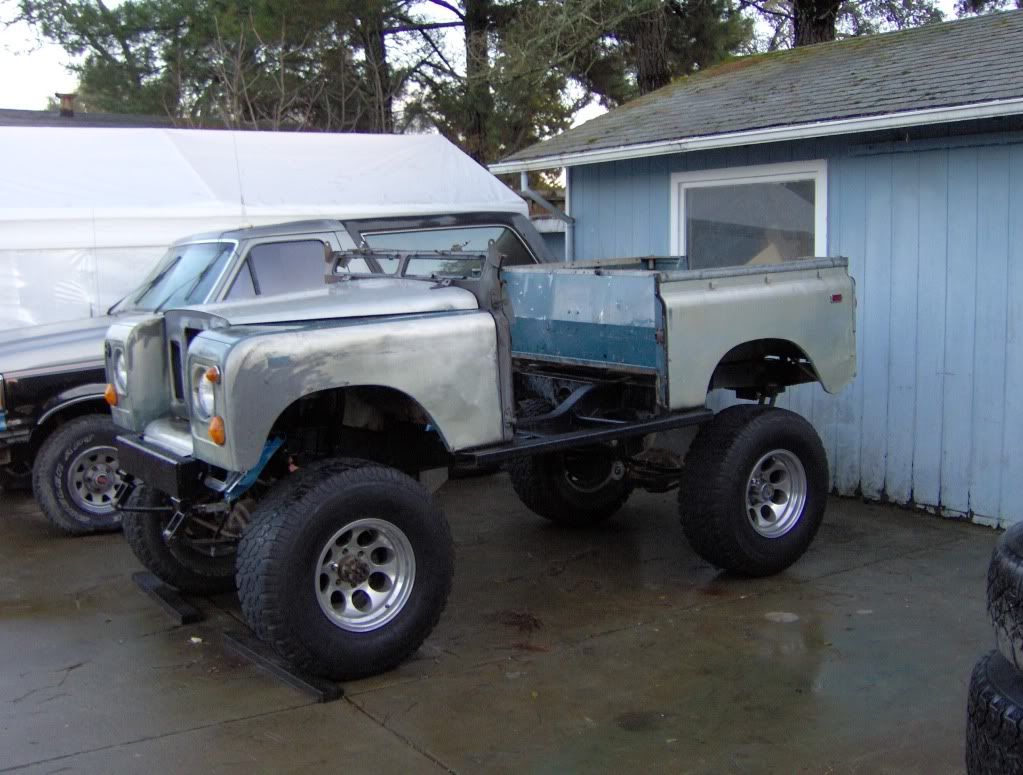

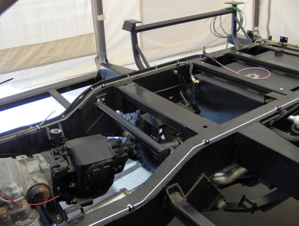

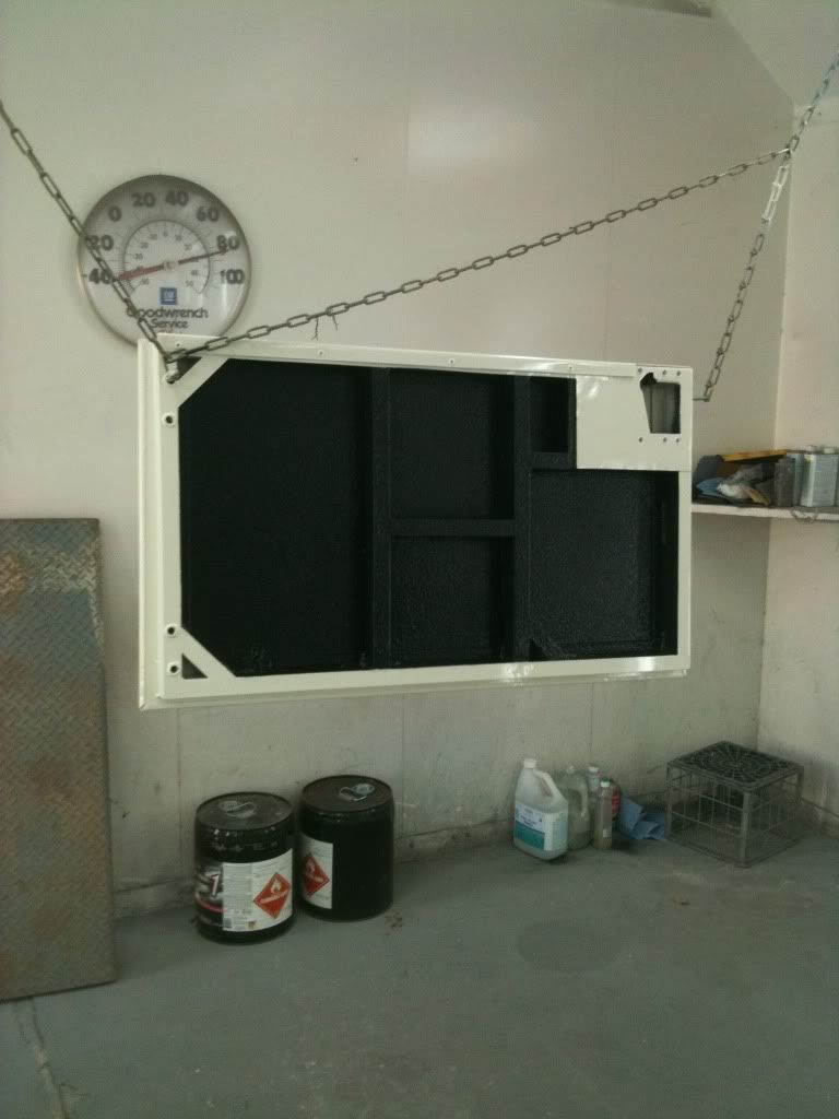

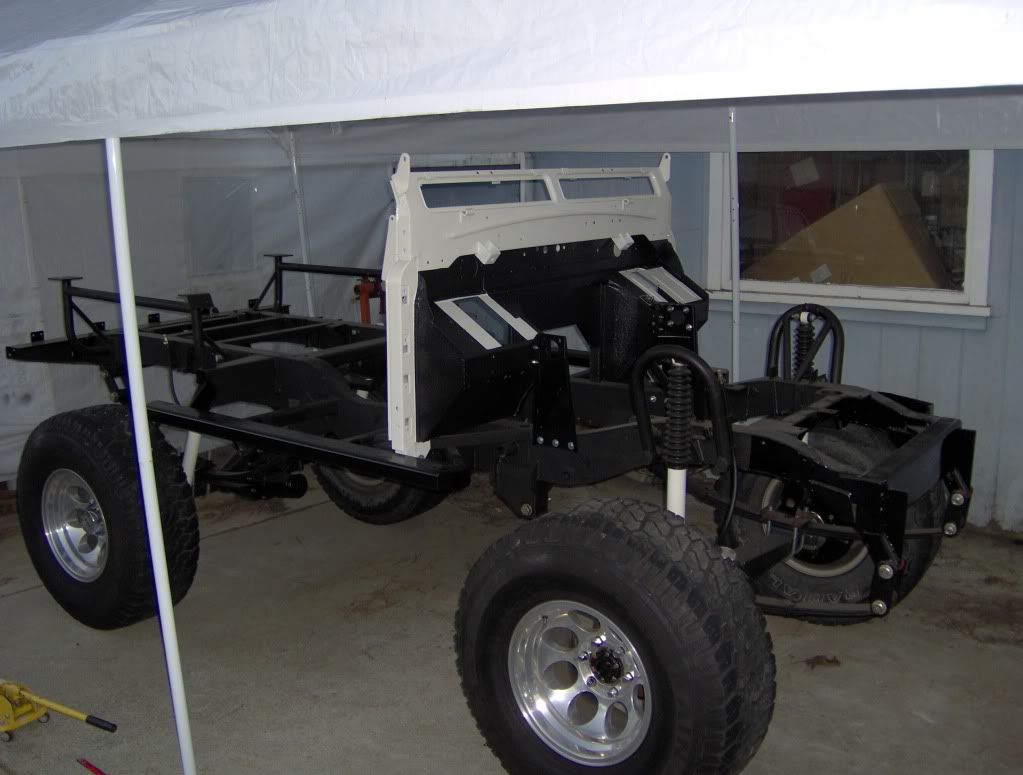

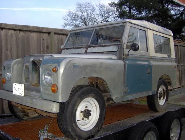

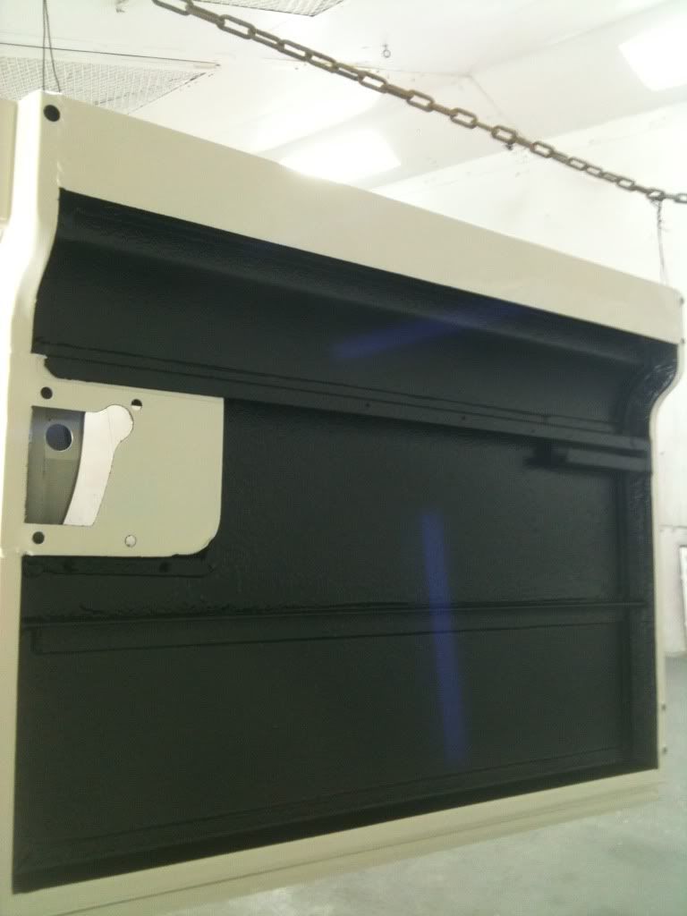

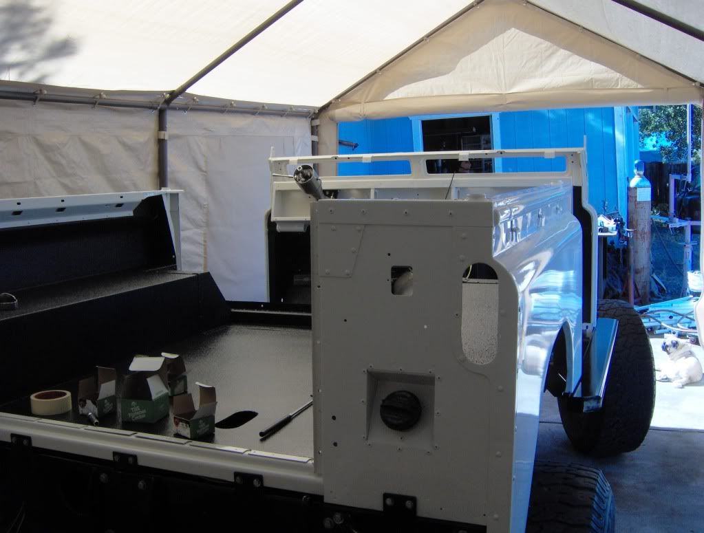

well guys here is some of the pics of the build. I have got a lot more done since these photos were taken and i will get some more recent things posted soon i hope that i can work this weekend on the cage for it but we will see. I cant wait to get to driver her in the spring. We are planing our first trip now in it down Baja in september of next year.

looks good but why would you turn the shackles around like that? its kinda going the wrong way. The reverse shackle is a much better design and will give much better drivability.

yeh that is one thing i am not very happy i did, if it has a bad amount of bump steer i plan on yarding out the leaf springs and going to coilovers. I built the shock towers stong enough to do that from the get go so i could do the upgrade at some point no matter what.

Great idea about the coilovers and the system you are running now will defiantly create bumpsteer. The rover looks good nice to be able to replace or rebuild every part. I'm building a 109 now and am using rear springs on the front for better ride with custom 2-3" springs under the axle. Keep up the good work.

I have road in many squar headlight jeeps that never had bump stear so we will see i have a few other tricks under my hat to help with it if it happens but i will be latter changing it i am sure. but for now it will due. the outlay of 1500 for two front coil overs was not in the budget at the time i was doing that. but there is always room for inprovment. I will post up some more recent photos these are very old so when i get time i will take some more and get them posted.
