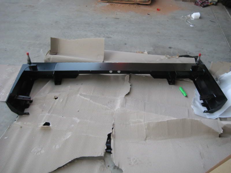

Rear bar and aux. fuel tank installation.

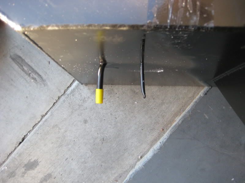

Managed to find where the camera was hidden...

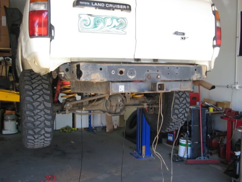

Rear bar removed, looking a bit bare.

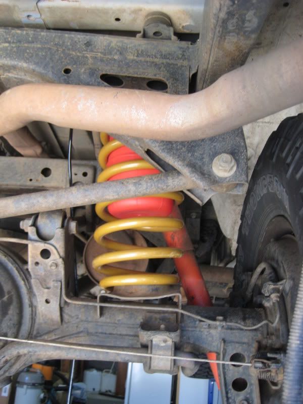

The rear coils and Poly Air Air Bags (more thoughs on these latter).

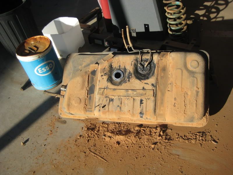

Out with the old, as you can see the red earth gets everywhere, a good sign this Cruiser has seen some country!

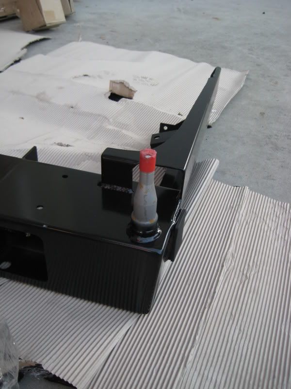

The rear bar and some details

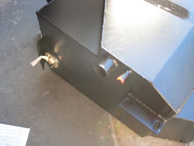

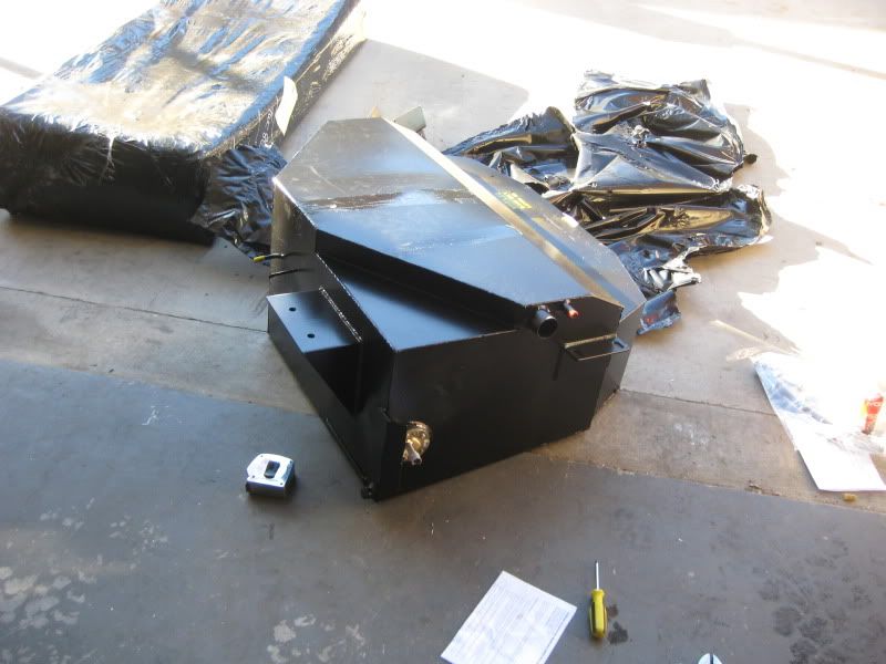

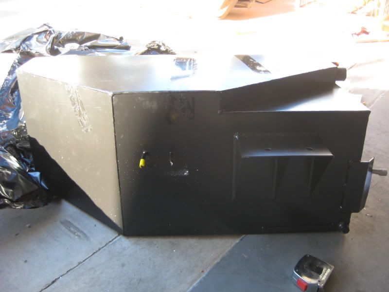

Feels like Christmas in July as we unpackage the aux tank. :wings:
That's it for install pictures because the rest of the time was spent installing the rear bar and tank because we were running very very late into the day thanks to the delivery company...

Well during the initial install of the long range fuel tank, rear bar, new coils and air bags there were a few outstanding issues to sort out.
  1. They had installed and ordered the wrong coils 1" lifted heavy duty vs. 2" lifted that were already on the cruiser.
  2. They sent two tire carrier swing out arms vs. a LHS jerry can holder and RHS tire carrier.
  3. The driver's side air bag punctured approximately 100Km East of Innamincka.
I had purchased all the equipment from a company called Opposite Lock. They have been distributing off road gear for nearly 30 years in Australia. Before my second visit, I decided to do my homework.
1-The coils I chose were made by a company called Tough Dog. Again, they have a large following here in Australia and have been arround since 1985. After doing my research I phoned their technical support number and spoke to one of their suspension specialist. I really enjoyed speaking to him because he took the time to ask all the correct questions before recommending a coil. It was good to hear that he was on the same page as I was and recommended the same coil I was thinking of using. First problem resolved.
2-They ordered the LHS jerry can holder so that was not an issue however, when we tried installing it, things went south... The tech doing the work was, how shall I say this politely, less than a perfectionist... After a closer inspection I discovered that the bearing race was not fully seated. I let the tech work on if for a bit but after watching in a state somewhere between bewildered and frustrated, I had to step in and take matters into my own hands. I was a bit late reating because the tech managed to shatter the bearign race by using a huge puch and 4lb mallet to remove it. Anyhow, turns out there was a burr in the metal preventing the bearing race from properly seating, a bit of time with the die grinder and all was well. Fortunately the arm that we removed had similar bearings that we could salvage but not before the tech managed to put two good size chips in the bearing race while removing it from the old arm. What really got to me was the nice shop press with bearing specific adaptors sitting in the corner unused...:costumed-smiley-007
3-Finally during our trip we had to do a "bush mechanic special" repair on the driver site air bag. More details to come in our trip report mentionned above. Anyhow, I was not convinced that air bags were the proper solution but they had been thrown in for free due to several other issues during the install day. I was going to remove them completely but the mounting bolts for the "soft" stops inside the coil had to be cut out due to air bag air line I could not turn back. They were good about it and chucked in a new set of 2" raised bags to match the 2" lift in the cruiser.

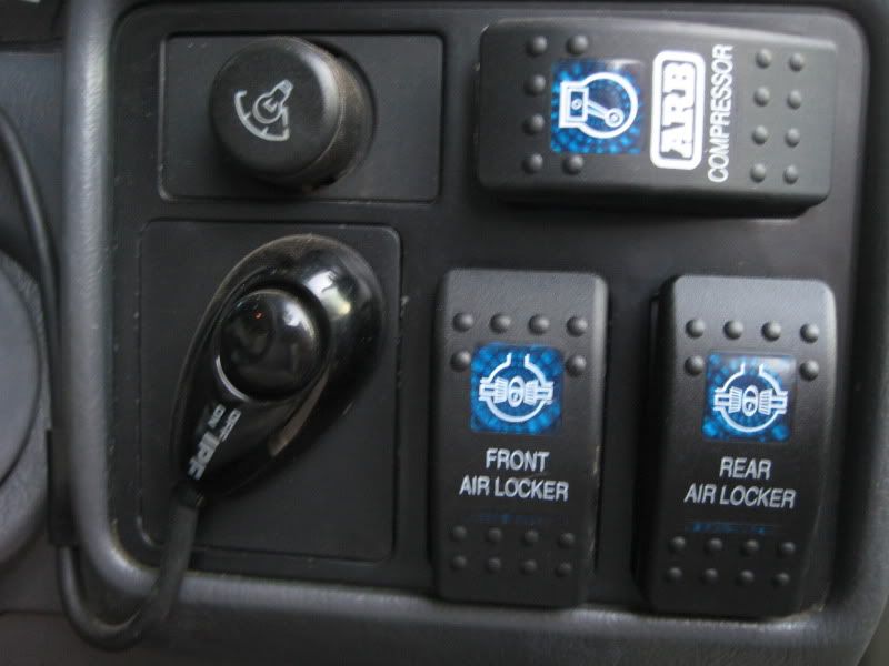

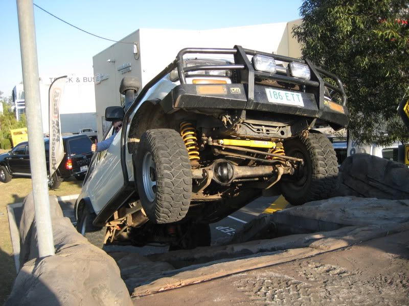

Well I've just picked up the Landcruiser from ARB today. There was a promotion that was too hard to pass up on Front and Rear Air Lockers. Just a few additional buttons...
Now if I worked at this place, I would never get anything done...
They have a hydraulic test ramp that you can adjust from mild to wild. I tried 3 different combinations, open diff, rear locked, front and rear locked. Amazing to see and feel the difference in a controlled environment. After the first climb, we cranked the ramp up a bit move and took a video. I'd post it but it's way too large: 116MB.

ARB had an excellent promotion on their ARB Air Compressor (CKMA12), Tire Inflation Kit, Tire Repair Kit, Front and Rear Locker. I'd been waiting for the right time and then this promotion came up. Too good to pass up.
