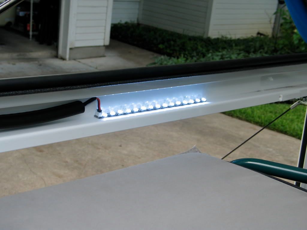

Installed some switched LEDs in the groove just under the main compartment lid.

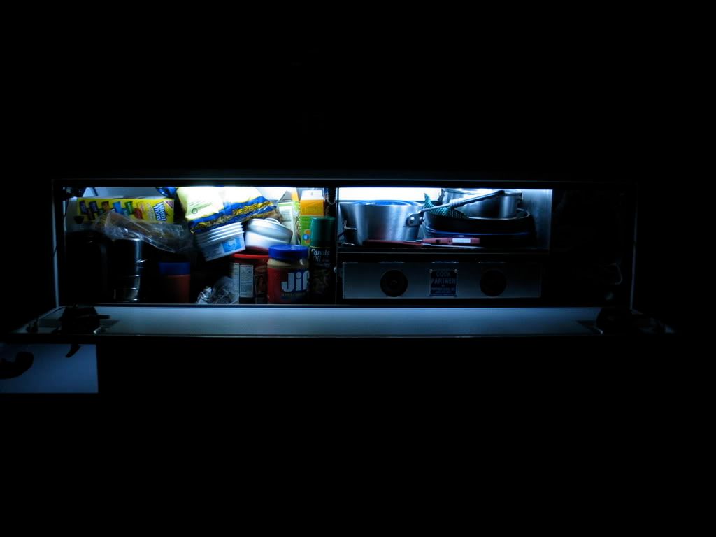

Did the same in the groove behind the lid for the kitchen compartment - put in two different strips of LEDs under main compartment and the stove.
I really like this mod -- great light output, low power consumption, and they are safe from damage, placed in the groove.

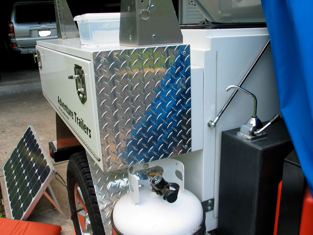

I noticed quite a number of chips -- down to bare metal with just a few trips on rocky roads. Installed diamond plate for the areas on side compartment that are prone to chips.

I like your LED mods. Think I'll do the same. We're in the beginning 'design' stage of ladder handles at the top. Having the ladder simply end at the deck is a bit uncomfortable for egress and ingress. I have a fabricator around the corner looking at some drawings I dropped off. The handles will be folding 'wings' to assist us older folks. :)

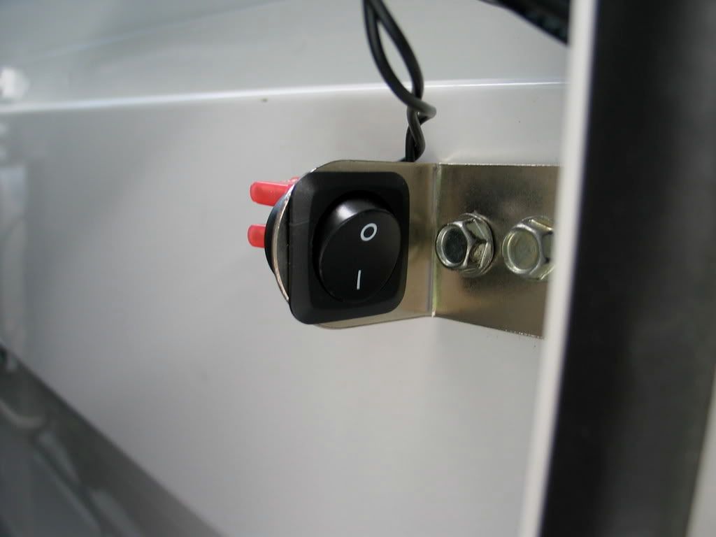

That is a great use of the 12V power outlet bracket! I will have to remember that.
Good eye! You must be familiar with these. I had one sitting around and had to buy another. It takes a bit of dremmeling to get the hole wide enough to hold the switch, which is from Radio Shack.

My Horizon boxes, propane tank, outside frame rails, etc. are pulverized/blasted from rocks kicked up from the rig. Gotta get the boxes Line-X'd or similar...and mud flaps on the rig to see if it will cut down some of the blasting.
Also I have noticed, in camp, bugs virtually ignore the LED lights...whereas the ARB flouro attracts them.
Tucson T4R
Yep, my KK uses LED strips and I also have found they don't seem to atttract bugs. Another nice plus. Where did you find your LED strips? I have breifly looked around but haven't found anything I liked yet. Yours look like just want I was wanting.
