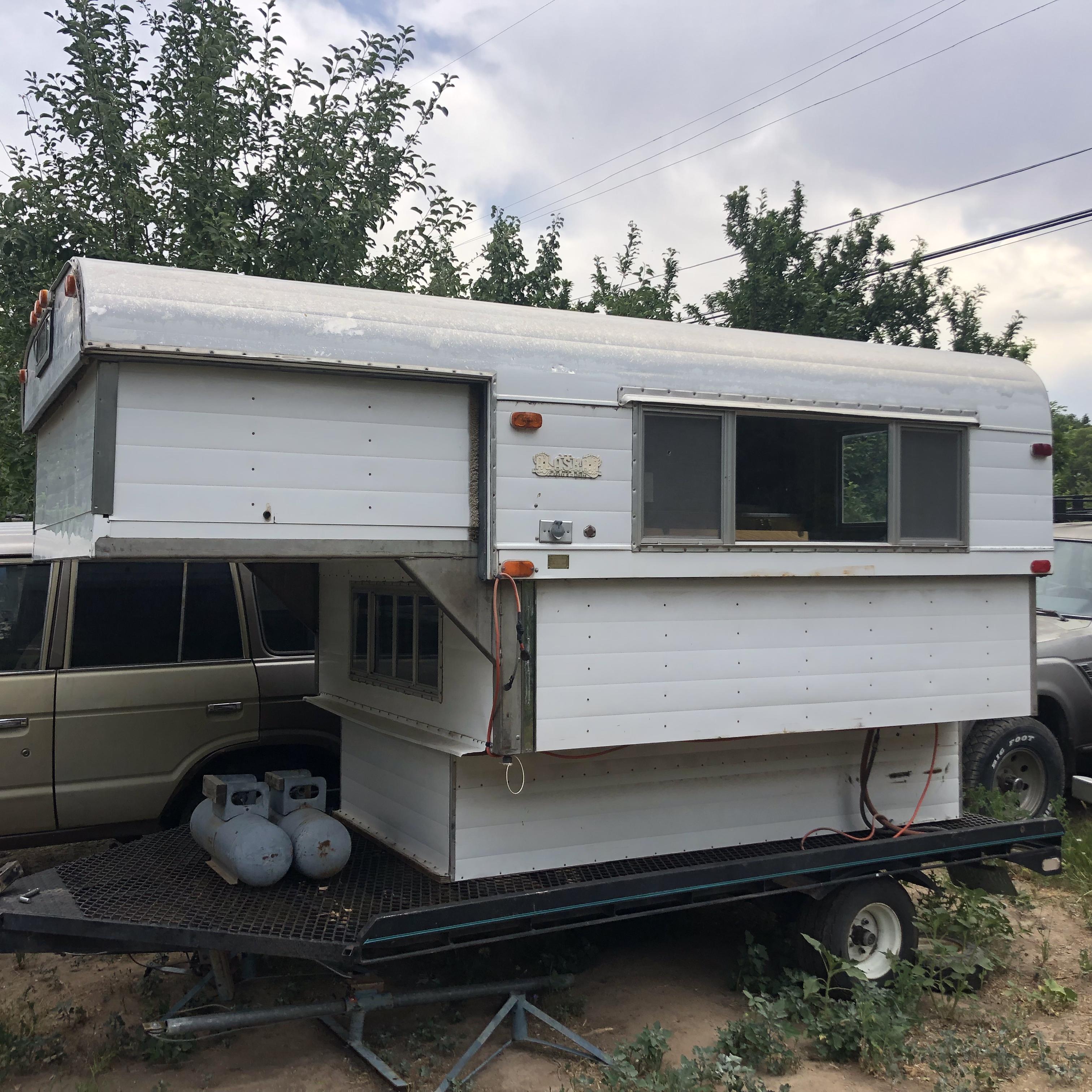

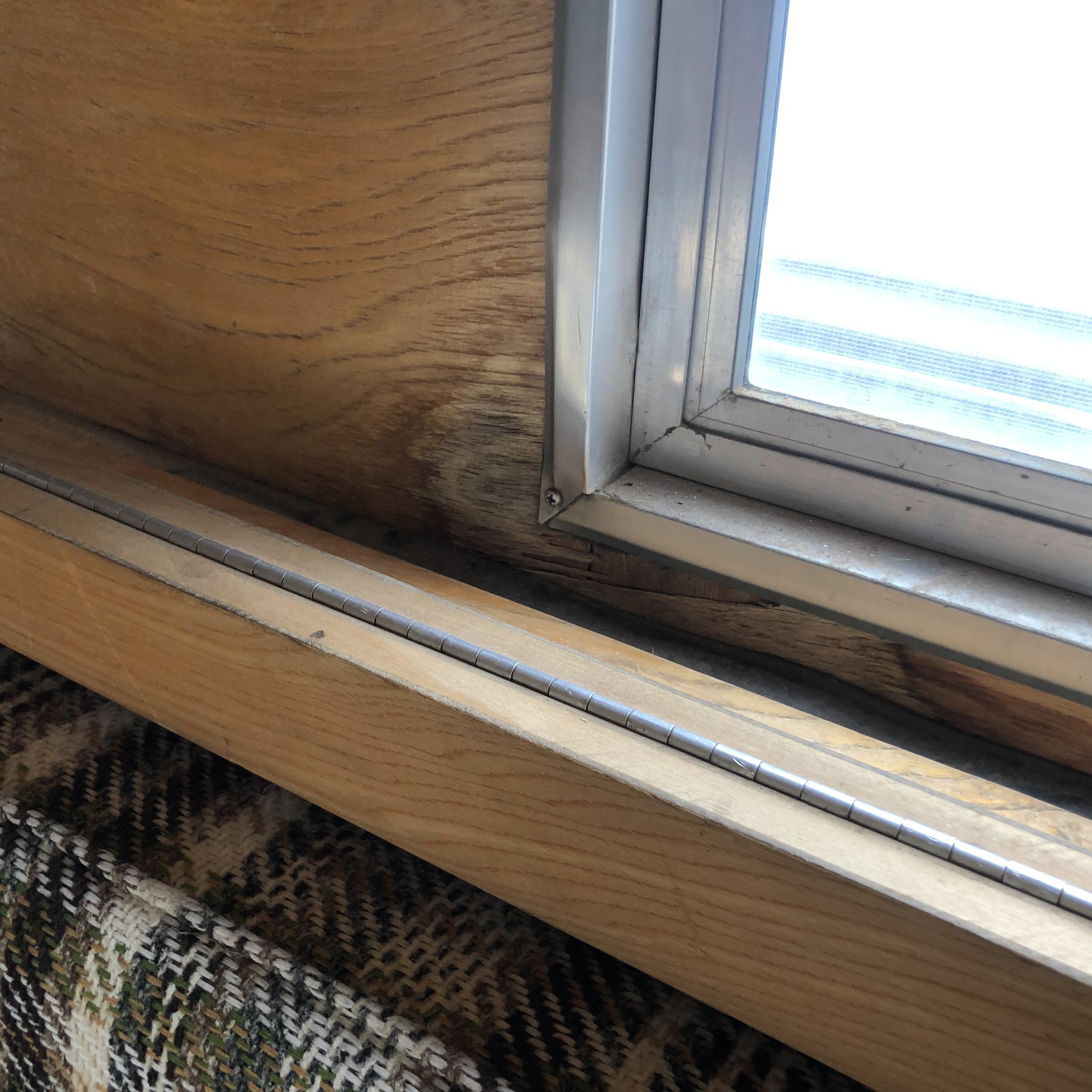

Time Capsule! All original early 70's Alaskan hard-side hydraulic pop-up camper. Amazing original condition. Inside is all wood, not Formica. 3-way fridge, heater, 3 burner stove. Goes up/down easy. New ones sell for 35-50K. Please research these amazing campers before asking questions. Has minor (old) water damage. See pictures. Will require 3/4 or 1 ton truck with 8ft bed. 6.5ft bed will work with tailgate down. Camper weight is around 2000lbs. Comes with 2 propane tanks and two jacks.

It appears to me that your "time capsule" will need extensive repairs.
Show us a written estimate from a shop to have that window area repaired properly. My guess is in $3-5000 range.
I see caulk falling out of the seams. To re-caulk the entire unit approx $1000-1300.

Location is Albuquerque, NM
Just so everyone is clear, this is my 5th Alaskan Camper, so I know a thing or two about them. I have never had one that old and that solid, usually top half bottom structural wood is gone on these (leaking pirelli seals) not the case here - it's good.
You bring up a good point about appliances and water. I will test and confirm. No idea about gas tanks, but I will take them to gas place and get them checked.
You can re-caulk entire unit in an evening with two people, plus get Pirelli replaced while you are at it - it has been done. Pirelli is $130 for entire camper. Caulking is cheap. Pirelli fixes your water issue, wood is solid, from there you either replace, or just sand and re-stain the panels. Not rocket science DIY.

Maybe you should call it a Project instead of a "Time capsule". Not everyone is a DIYer. To have this unit professionally repaired will cost serious $$.
As for the sand and re-stain comment, your picture shows that the panel is shot and most likely the window framing will also be damaged.

The insides wood is a layer of 1/8ply typically. that can be trimmed up until the structural wood is good. The woodwork to repair is "gameroom" level difficult. the top need not come off. remove stops and pump it up until the top section is parallel to the bottom and go to town.
depending on how the siding was done, i dont recommend calk as your main way to handle the edges. I would scrub the siding and then use eternabond tape. if its going to overlap, think ahead what piece goes first, its not forgiving of removal attempts. I would seal the top section roof seams 100% with 4" eternabond tape. i completely redid a 1973 interior and the top leaked when i had not used it for 6 months. i had to scrap it. the tape is siding white, and if youre planfull and coordinated it looks like it belongs.

Aluminum frames sweat my boat interior has stained teak from sweating like this also. Trust me leaks are much much more obvious.
Every few years I bleach the stained area and re oil it and it looks fine again.
My parents Alaskan this vintage had a saggy roof from snow loads, rough road bouncing and water damage to the roof structure which eventually did it in. All campers with aluminum window frames have sweat stains on the corners.
