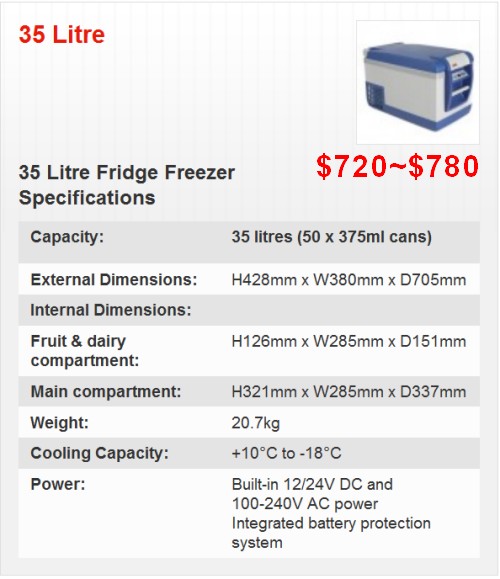

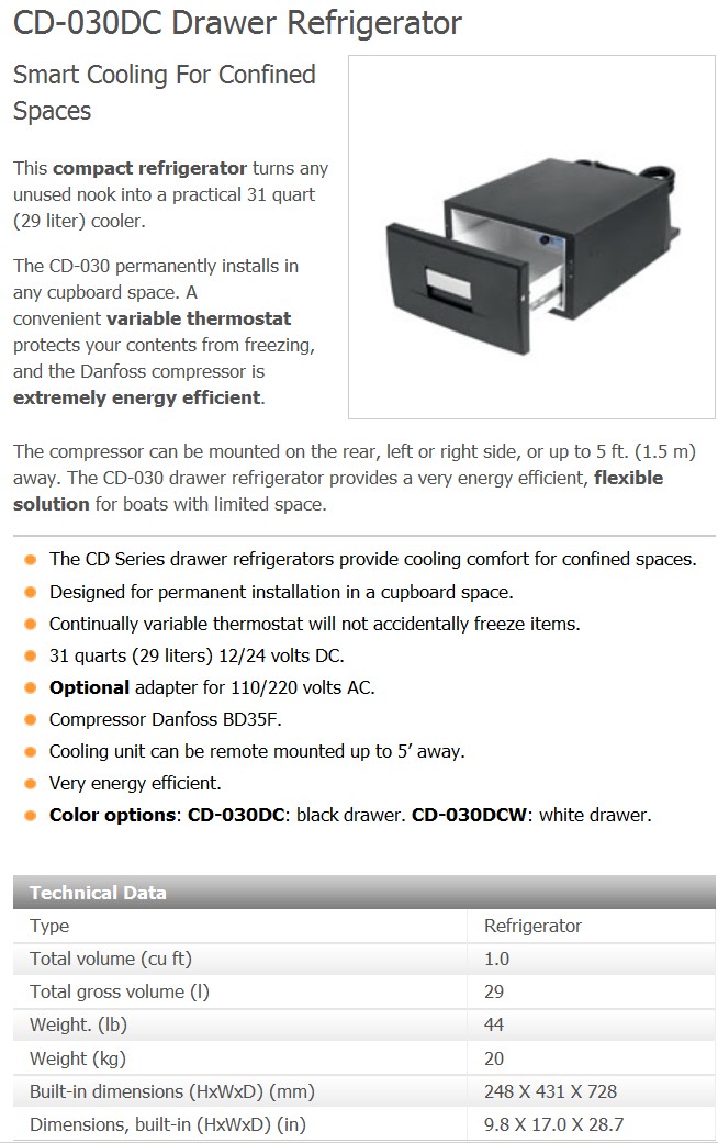

> 11- Cooler or Fridge: ARB Fridge. Hands down
Why? Have you seen the Waeco CD-30, isn't it great to place the compressor away from the cabinet and be free of the noise?
I have not seen the Waeco CD-30 but I am working on a custom install using a ARB Fridge and I can say it is almost silent, plugged in to my house it is quieter than my PC and only has a very slight fan noise but not any compressor noise.
The ARB also seems to have a large amount of space on the inside and is laid out nicely.

I have not seen the Waeco CD-30 but I am working on a custom install using a ARB Fridge (...) only has a very slight fan noise but not any compressor noise.
I am willing to spent 100 bucks to buy one small refrigerator and convert it to a car unit. With the possibility of placing the compressor outside, noise is no longer a big concern. The ARB cost from $720 to $780 vs $530 of the Waeco. I also think the CD-30 has the most inteligent design for using it inside the trunk.
Indeed, I think it is even bigger then what I am looking for, the smaller model is 35 liters. Although this is a long journey, I don't plan to cook on a day to day basis, the fridge will be most for liquids and snacks. This is why I was also considering a cooler instead of a fridge, its smaller, cheaper and some are noiseless.
