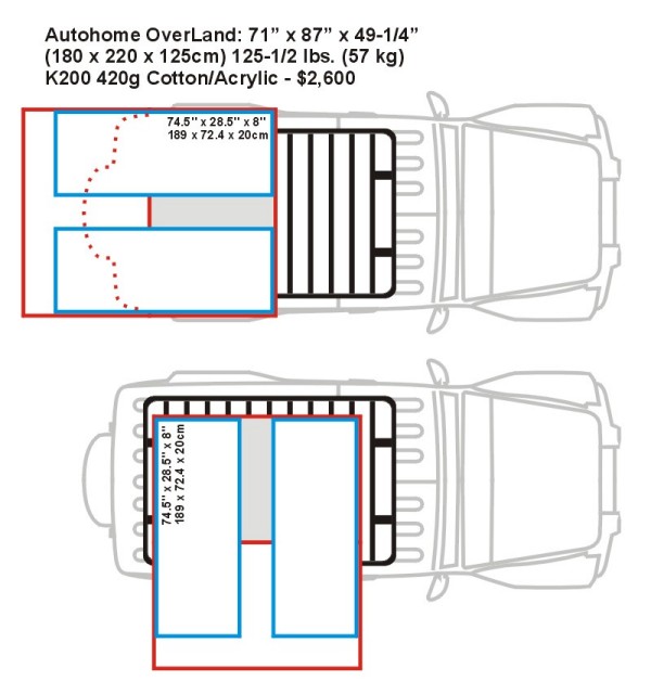

Im going to have to cast my vote for the MBRP rack. It is modular so you can set it up for anything you want. Right now I have a tent and an awning mounted. It can be half length or full length, and they say it supports up to 1,000lbs.
I like the design of the MBRP, it is one of my favorites, tie with Gobi, mmm maybe Gobi is a nose ahead.
What is the size of your tent?
It supports 1k lbs? That is overkill. 600lbs (static) is more then enough, if it really can take all that load then it is probably heavier then it could.
Vizoo
My vote is AutoHome; I use a Maggiolina for close to 10 years now and just love their quality
This is the biggest they have and I would prefer a larger one.

Rack you need a flat part to fit the RTT, multiple mounting points required !
again you could have made locally.
mines made out of galvanised electrical conduit........made in my garage.
Weight kills vehicles off road, the lighter you are the less stress on everything.

Indeed, next week I will see if I can find a shop to do a custom one in aluminum.
