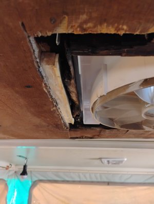

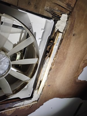

I knew it was leaking a bit, was hoping it wouldn't be this bad. Anyone dealt with this?
I feel like any solution I come up with is going to be wrong and this is a no-win situation, but I'm thinking I'll cut the ceiling past the rot and piece together 1X and panels to fill in what I cut out, then just seal it up nicely and pray🪚🙏
I'm worried I'm going to mess up the fiberglas roof in the process of messing with the ceiling.

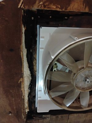

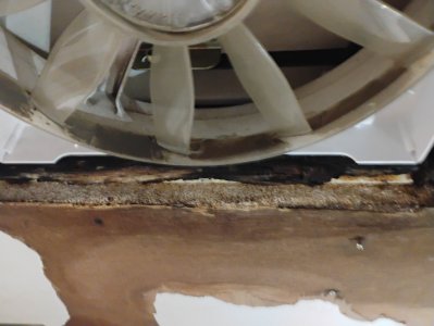

Upon closer investigation there turns out to be a foam layer in the ceiling and the rot never made it past that, so just the perimeter of the vent is rotted out. Going to fill in what I can with strip wood and epoxy, then go way overboard sealing it from the topside.
For the record cussing will not fix it, neither will crying, I've done a bit of both. 😆

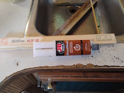

Ok check it out I had an idea, I'm gonna jam a couple stir sticks in there and epoxy em into a brick. I didn't get any fancy RV products for the roof because well
Used a ¾X¾ strip board and stacked a paint strip, that'll give me some structure to screw the vent trim back into. Then I filled the rest with a putty. Once everything harderns overnight im going to brush on a coat of sealant, put the trim back up, then I'm going to use a spray texture to cover where I ripped down the wallpaper.
JB Weld for the win!!
