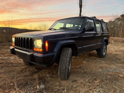

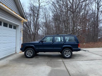

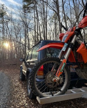

Alright. Suspension’s together and I’m friggin stoked on it. Crown coils and General KC leafs (both Up Country), Bilstein 4600 shocks. For tires, I had some requirements:
1. Road biased all terrain
2. Three peak mountain snow rates
3. Under 35lbs per tire
4. Readily available because I want it now (I’m a millennial)
The Toyo Open Country III passenger car tire fit the bill. I’m willing to sacrifice some durability to have a more pleasant tire on the highway since this is likely to be my commuter for awhile. I opted for 225/75r16 to get a bit more height and keep weight down. Initial impressions are great. The Jeep handles better, looks cooler, and carries the weight of my dual sport well. Absolutely chuffed. Gonna take the Jeep out for a day trip tomorrow to run some gravel roads in the mountains. 👌

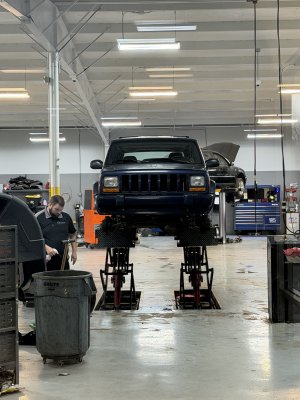

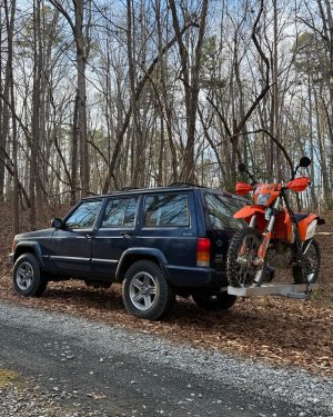

Side note: I need a lift like that buried in concrete in front of my motorbike shed.

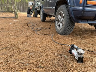

A couple neat goodies to make life a bit easier: I ordered a RAM suction mount so I could use my quickgrip and NAV phone in the Jeep (been using an old Kyocera and OSMAND for motorbike trips for years). Also grabbed a Viair 88p since my little 12v compressor that I used to carry on the bike would take FOREVER to air up four larger tires. 1767704143821.png1767704170460.png

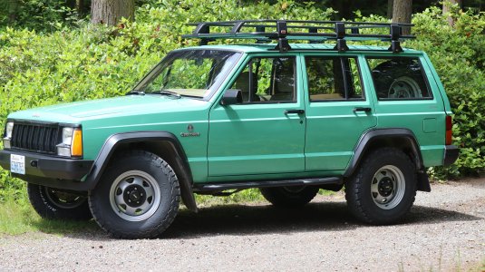

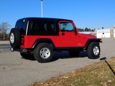

Very nice! I had the ICON 16 inch wheels on my XJ with the same tires and it was great. I also have the aftermarket Upcountry suspension and it works great as well. Recently went back to stock steelies with 30x9.5 15's and BFG A/T's for now. Same diameter as 225/75r16's basically, but prefer the look and added side wall height. It's absolutely amazing what you can do with an XJ on 29.3-29.5 inch tires. Anything taller and your looking at regearing.
