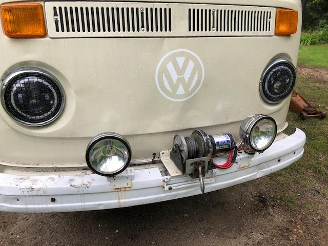

Big Thanks to a member on the Samba (former Superwinch engineer) for sharing his knowledge and guidance on getting the winch wired up and working. I’m pleased. Gotta ditch the bracket in front of the fairlead so I can properly wind the cable.
Switching solenoid and wireless control, wired up from battery to solenoid to winch with 0/2 cable.

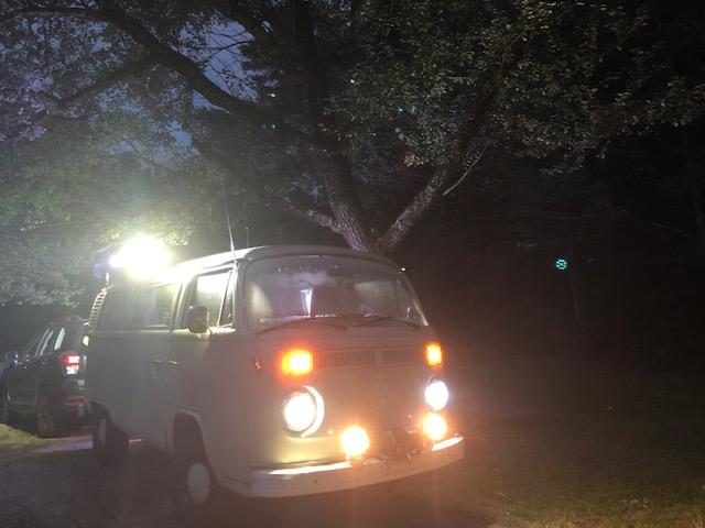

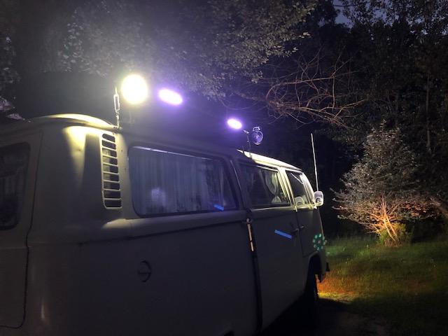

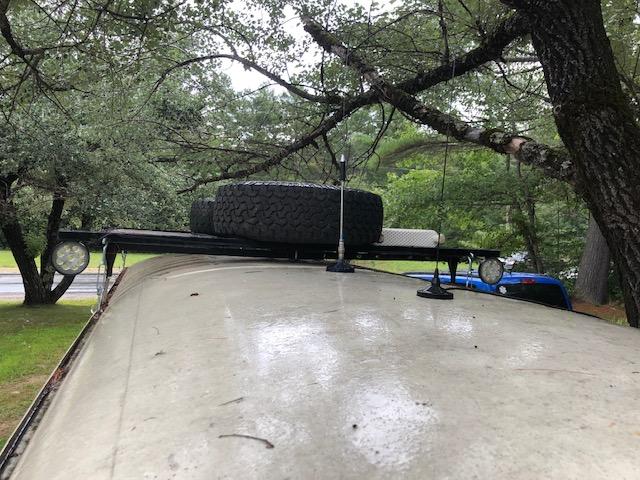

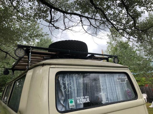

Mounted and wired up some 27w LEDs front and rear on the rack, switched from the cab so I can select front, back or both.
Image may have been reduced in size. Click image to view fullscreen.

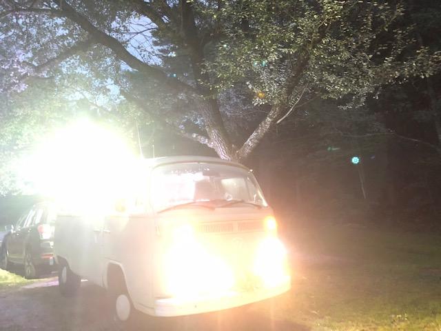

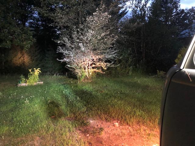

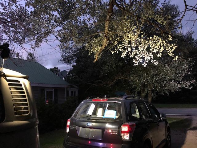

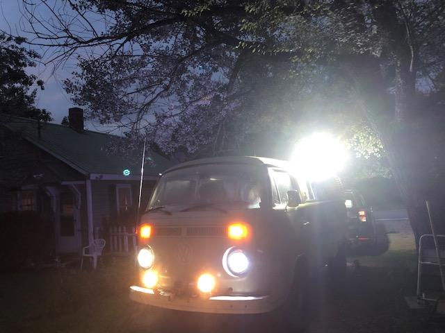

When combined with 200w LED headlights and old school 100w incandescent auxiliary lights, throws some good daylight forward and back, plus good broad downward out the side windows without glare
Smile
Back

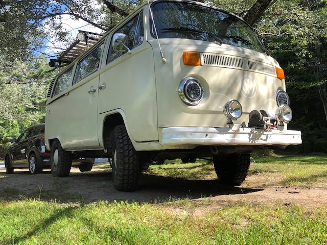

Front (LED directional/parking lights as well)
LEDs for license light, stop, turn, parking)
