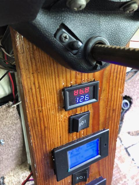

Put shunts on both the house and bus electrical systems, ran the cables, ran thermocouple extension for CHT since I was already pulling wire back to front, and cobbled up a center stack out a scrap of barn board, hit it with some poly, and mounted it to hold the meters. I put DTDP switches inline with both ammeters, that way I can see both pull and push just by reversing polarity of the reference leads. CHT all set now too. Put in two other DTDP switches for later use while at it. Now know my 2 ham radio pulls 8.8a when transmitting, and the starter pulls 104 when cranking

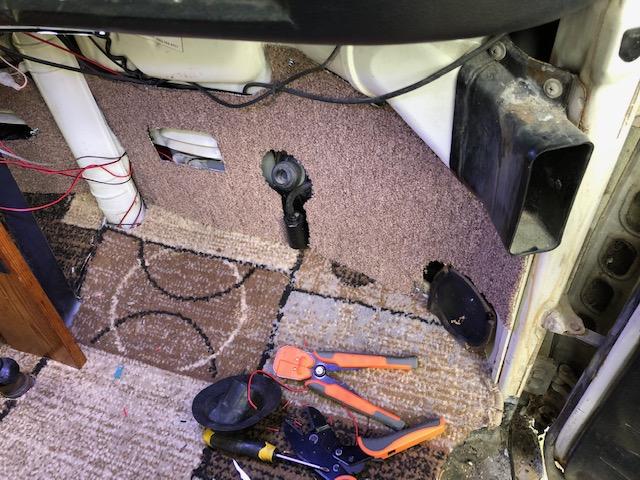

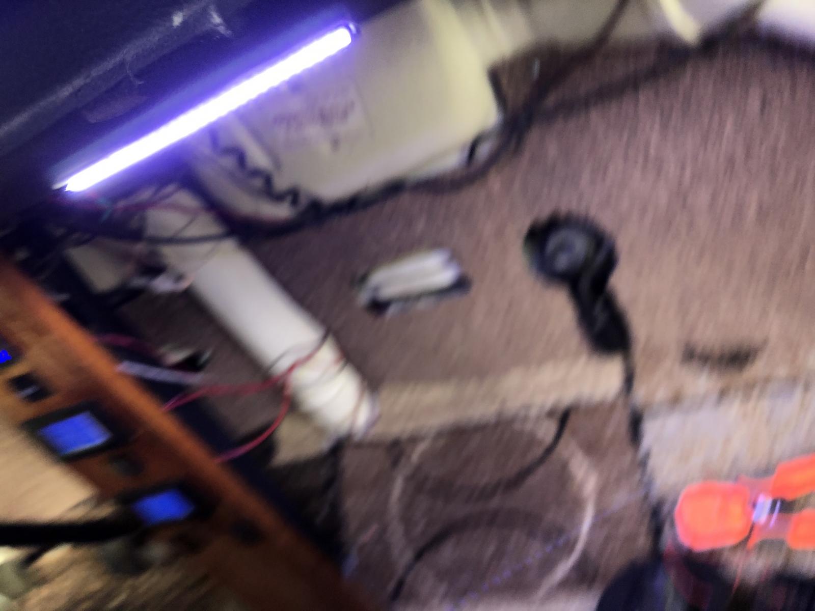

And while I had the kick panels off, I rebuilt the door switch for the dome light and wired in a footwell LED on the passenger side, it can also be activated on demand by a switch next to the defroster knob.

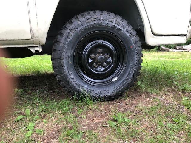

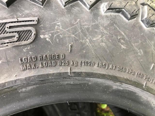

Arrived today but can't get them mounted where I bought them so I'll do it myself and then take them to VIP to get balanced. Achilles Desert Hawk XMT 27/8.5R14. I like the look of them, hope they look good on the bus.
Image may have been reduced in size. Click image to view fullscreen.
sweet, I was having a hell of a time finding AT/MT for my bus since BFG stopped making em in our size.. cant wait to see how they look
I took them to another tire shop and got them done this morning. $400 for the tires, $80 for mounting and balancing. I'm not disappointed. I hope they are noisy as hell :D :D :D

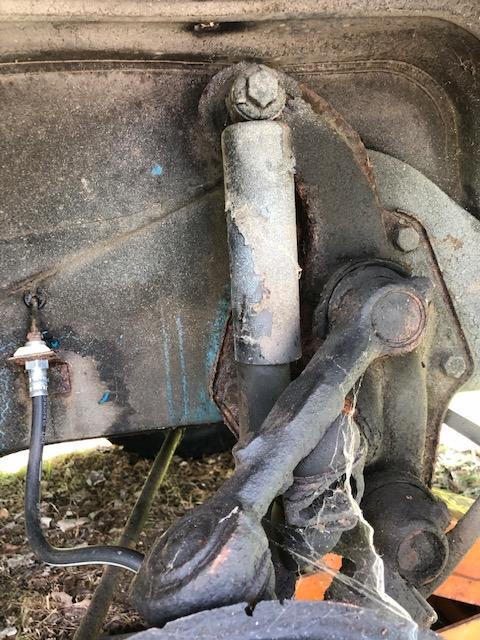

Decided to do one more easy win, out with the original shocks, in with some new GR2s up front. I didn’t do the rears yet, will do those when I reindex the torsions. With the intake boots shot, it can’t move right now and where it s parked is not the best spot to deal with that job so will wait. I have a level spot with firmer ground where I park my daily.
