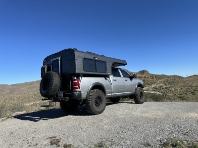

Well, here we go. Ive had quite a lot of different campers over the years. From sleeping in the back of many different XJ Cherokees, to sleeping under a Softtopper on a Tacoma, to a GFC, to a UJoint converted Thor RV, to numerous Four Wheel Campers including my 1978 Chevy Blazer with a period correct Four Wheel Campers Blazer that Ive got a thread about here.
This one is different. Its a brand new, built to my spec Alaskan 650si that I picked up on December 15th, 2025. Rugged Grey exterior over Klondike interior. Riding on my 2024 Ram 2500 Tradesman Power Wagon on 40s. Some of the specs include 12v air conditioning, inside toilet, outside shower(by choice) 2x162ah lithium batteries, 1 Zamp 190 watt solar panel, Victron 150/35 mppt controller, Redarc BCDC 1225(that I wish was more powerful) and all sorts of other goodies. I plan on documenting all of my mods and adventures here like I do with my other rigs. There arent a ton of new Alaskans out there, in fact Ive never seen another grey Alaskan outside of an RV/overlanding show, so ask/comment away. Im happy to help anyone thats interested or just has feedback.

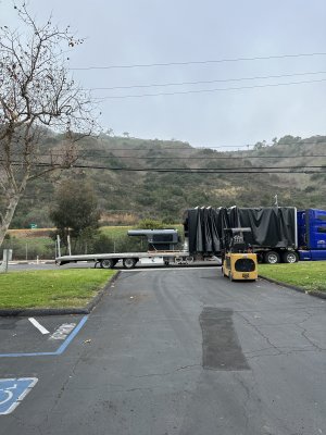

You in So Cal now? Pretty sure the first pic of the camper on the trailer is at my exit in San Diego.
Edit: Ah, I see you picked up at TCG.
