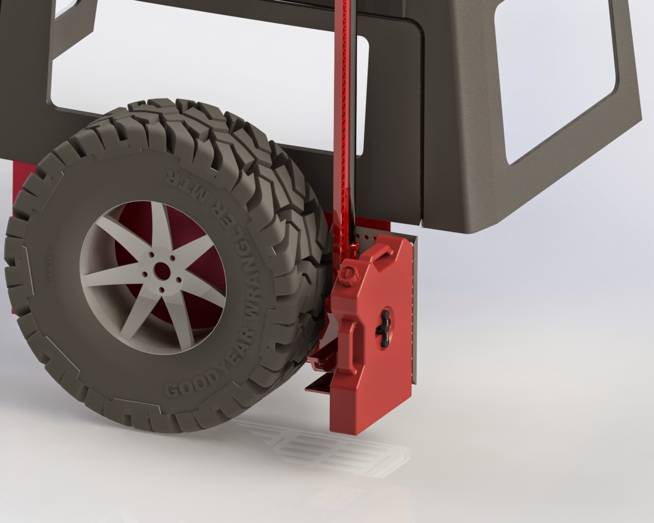

Here's another variation of the hinge mount. You will also have the configuration to carry dual rotopaxs and have enough room on the plate by the tire to mount a set of quickfists.
A great setup would be to carry the hilift and two rotopaxs. Here is what it may look like, we will have to do some test fitting to see if this will actually work and it would probably only work on the hinge like mine with the offset hinge pin.
All of these will be tested in the coming weeks with pictures on a JK.
