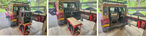

I also put the kitchen back in for the trip. It's very easy to install/remove, so I only have it in the Jeep when I have a need for it. We'll use it for meals on the trails in Utah and for meals at Overland West. I keep the kitchen in the garage on a Harbor Freight cart that's about the same height as the floor of the Jeeps. I roll it up to the back of the Jeep and slide the kitchen off the cart and into the Jeep, no lifting required. It secures to the floor with three bolts, and I use studs in place of bolts to align it - it's easy to slide the kitchen in place, dropping the holes in the base over the studs. Then I remove the studs and put the bolts in place, easy to do because the studs lined up the holes.
