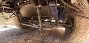

@SkiFreak you have a point, Australia has more options. Can you point me to a part diagram of the NPS front axle ? or picture with the wheels off?

I do!
That said, I don't know of any diagrams of the componentry, however I went out and took these three pictures. The fourth one is the front axle hub assembly, unfortunately not quite what you are after...but. The fifth one is a still from a video on you tube as it ascended a bit of a hill during a comparison between the NPS and a Ford Ranger ute.
The NPS front axle is 3100kg, while the rear axle is 6600kg with the entire truck maxing out at 7500kg. Depending upon whether you get 17" rims or 19½" rims will decide your final maximum weight. With 17" rims, you are restricted to 7000kg, which is 3100kg front axle, with the rear tyre rims combination maxing out at 3900kg for a total of 7000kg.
Using 19½" rims and the appropriate tyre combination, an NPS 300 retains the 3100kg on the front axle, and can legally carry 4400kg on the rear axle for a combined total of 7500kg.
The NPS runs hydraulic drum brakes all round. Also in Australia, as it is brought in as a country (bush) fire fighting truck, National Park truck type of thing, it doesn't have a DPF. Which is great as driving through grass one could unintentionally light things up.
The second best accessory for these little trucks, is a replacement Torsen style front differential. Totally transforms the experience in loose gravel/shale, sand, mud and within reason, bog holes. Whenever you engage the front axle, you have torque being applied continuously from left to right, the surefootedness steering feeling is immediate when you press the 4x4 button. The NPS comes with a clutch pack LSD rear differential, and it is very good, and when combined with the Automatic Torque Bias front differential, correct tyre pressures, then this little truck just bops along.
