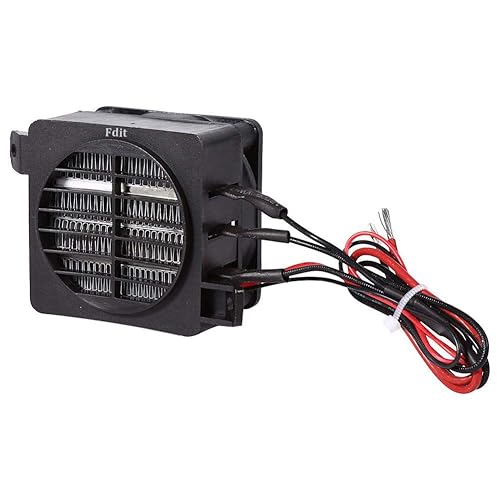

So, what to do now? I found some chintzy 60mm heaters - literally a 60mm fan on a radiator that heats up. The 100w advertised units are typically 50w from reviewers, and the 150w advertised no one mentioned on actual draw. So I ordered one of each - if the 150w is 50% its rating it'll work fine. Will probably mount on one side of the can blowing to the other side (probes are all on opposite side of heater)

The 150w incubator heater arrived a few mins ago and was promptly connected to one of my portable LFP packs with a little TK15 coulomb meter.
Thing was pulling 194w. So that sucks, I was banking on it being half (or certainly less than) the advertised power like the 100w unit allegedly is. Maybe it had a problem and would have run away, melting to a pile of goop. I didn't let it keep going to find out. Wiring to the actual heating element was 14 gauge and adequate for all of its four inches. Fan was setup to push air through the heater instead of pull through. That's actually ideal for how I intended to mount this thing. Air movement was pretty weak but may have been adequate.. I'll never know.
100w that apparently pulls 50w is getting delivered later today.
I discovered these have separate leads for the heating element and the fan which isn't the worst thing even though I have just a single relay in the can to control heat. I'm having this idea that I could wire relay out -> digital heat controller board of which I have several, and wire the fan to the IN side of the thermostat board, too.
Means if relay is on then the fan would be on, and the thermostat would receive power. It'd be up to the thermostat at that point to get me to the appropriate temperature range, but overseen by the microcontroller operating the relay (also based on temps). If the thermostat failed open then the relay would still disconnect later when BMS + probe temps got hot enough. Additionally, if the actual relay failed open, the thermostat (if it hadn't also failed) would keep things in check.
Also, if the relay was on between 40 and 50 degrees and the thermostat was set to 45*, I'd get some air movement in the can before and after the heating cycle.
