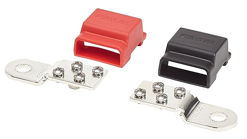

Is this sufficient for connecting to battery main + and -, and then attaching applicable (2 per) balance leads, or will that impact accuracy? I'm finding this needs to be the best connection possible or I have freak outs like last night, and it's certainly no good for meaningful BMS protection and balance charging if squirrely.

Are you following the current rule for stacking the terminals? Highest current on the bottom? A torque wrench for the nuts can't hurt either. You need to make sure the terminals are nice and flat, high quality units. More contact area is better.

I think with the BlueSea terminal bus bar I posted above, I could connect the BMV temp & + connection to the stud. It's too big to fit on those four little screws. But everything else could go on those 4 other ones.. That'd limit me to probably 10awg wire going to my fuse block, and to my battery protect. I'd like to go bigger, so maybe I'll connect them directly to the studs too and on the positive side put the BMV temp stacked. That damn thing though, huge rectangular lug..

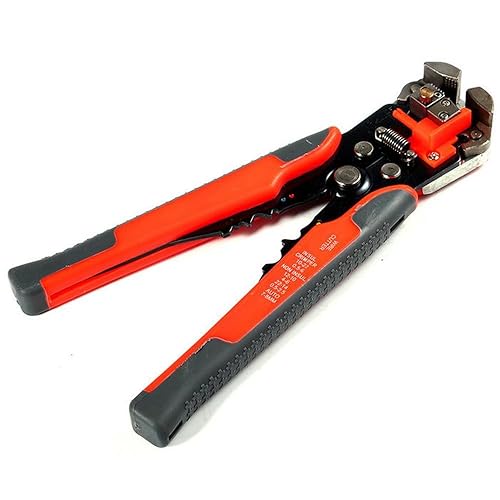

One from amazon a few years ago. Works a lot better than the $8 yellow or red handled ones you can get anywhere. Makes a solid square indentation in crimp ends. Strips most wire pretty well, softer jacketed stuff sometimes struggles but for the super flexible silicone stuff I've found it best to use an X-acto/razor blade. Hold on table and roll wire forward and backwards, then use teeth to pull it off with ease, zero loss of wires. This one can mangle soft stuff on occasion. Dedicated tool for Anderson PowerPoles.
When I built my portable packs using batteryblocs they came with quite a few uninsulated ring terminals. I almost like those better and should probably try to find a bag of 100 online. Easy to crimp, add solder if you want, and then slide heat shrink over the whole shebang. Perfect for balance leads.

That the combination crimper and stripper is fine for uninsulated terminals, but do not use it to crimp insulated style terminals. Those should have a flatter die ratcheting type crimper.
Alloy
Well-known member
I tried allot of wire crimpers. Found ratcheting double crimp to be too wide or dies don't compress 18-20ga connectors enough.
I always have my Kleins if I'm not crimping with then I'm cutting wire. Cutting wire with ratcheting crimpers is time consuming.

These are the wire strippers I use. If I'm stripping 18ga I use the slot for 16ga and so on. On 10ga l make 2-3 cuts in the insulation.
