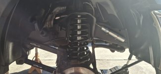

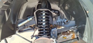

Front is mostly done. Just waiting on new lower arm cam bolts. The old ones were just hammered with corrosion. I'll then button it up, grease everything, and give it an alignment. It wasn't without some fun however. That axle is heavy AF. And my finger paid for it. Not broken, just bruised, but boy howdy!!!
View attachment 855445View attachment 855446View attachment 855447View attachment 855448View attachment 855449View attachment 855450View attachment 855451View attachment 855452

Wow, nice job on that front end! Looks brand new again!
Yes it's a throbbing today for sure. Things definitely showed down since. But it's all but done. Just need to put one new end link on, put on the tires, then do an alignment.

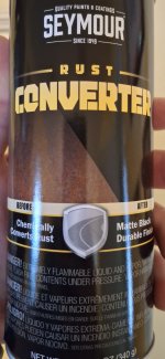

I used Steel- it. I love the stuff. And I use Seymour rust converter for any remaining surface rust that may have existed after sanding, before the final paint.
That steel-it sure does a nice job! But wow it hits the pocketbook!! Great looking truck!
Yes it's not cheap at all, but I've yet to find anything better finish wise/strength wise. It's pretty well on par with marine grade high end epoxy.

Awesome! Yes I think you will be impressed with them as a product. Just remember, it's honestly 90% on the prep, lots of wax and grease remover, LOTS of sanding and allow the rust converter to do it's job for 24hrs. I generally do a haze coat with it, then come back and do two medium successive coats with the converter. Then wait 24hrs. Then I do a light sand on the shown surfaces, wax and grease remove it, then spray steel it. Be ready for the blast with steel it, it's about double the spray force of a standard aerosol can, and comes out quick. So haze coat it lightly at the beginning as best you can, then do your thicker coat/coats. And don't worry if it's blotchy at all, that will go away completely when dry.

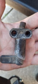

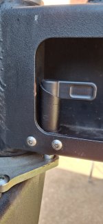

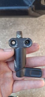

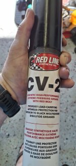

Alignment complete, and it rides SOOOOOO much better now. It's quite ridiculous the difference to be honest. I used CV-2 Redline on all the grease points yesterday prior to this mornings appointment. And added the swing out locks on both sides to replace the old bent ones on the EXP One rear bumper.

It's really not that bad. Wiping it down and sanding what you want smooth really doesn't take long, and if you don't care about the finish as much you can skip the sanding, just clean, convert, then top coat.
