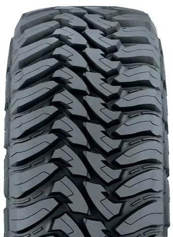

Then today I finally got the wheels on. This is zero lift, stock height with 37s. It rubs VERY slightly at full lock on the plastics at the rear. I'll be adding the springs and shocks here soon, as well as the used Carli arms, which are 1/2" longer.
