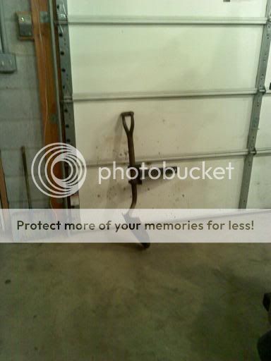

Thanks, I built a piece of 2" receiver stock into my tire carrier so I can plug in different accessories. The shovel carrier is just a piece of 2" box with a flat plate welded on . The plate has 2 quick fists that hold the shovel. I also made a cooler rack
