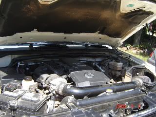

saw a thread on CF where a couple guys had figured out a way to fill in the gap created when replacing the OEM airbox with a CAI and really liked that idea.

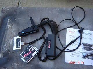

Unichip PNP Installed
This weekend I installed the Unichip Plug N’ Play Computer. So far I am very happy with the results. The standard setting bascially makes my truck feel like it did before I put 33.6" tires on it, and the performance setting will through you back in the seat. :bike_rider:
