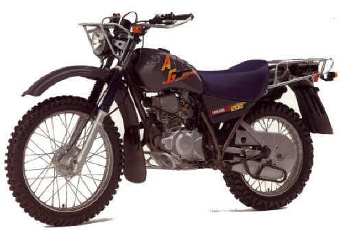

Ag bikes are a great option. Yamaha do a good AG 200 and you'll find parts and service for them in every outback town with more than 2 pubs. Just not sure if you can get them with a double seat.......hmmm. No rocketship but very compact and ultra practical. Come with stuff like big mudflaps, crash bars, very comprehensive toolkit, enclosed chain, front and rear racks, knobbies, handbrake, oversize side stand, etc. ...extra low seat and overall height too which should make them easier to load on to a high rack ......well, I presume your rack will be extra high if it's going onto the back of an expedition-style FG. BTW PM me if you need a winch arm to drag your bike up to a high rack. I know a guy that makes racks that clip into a 2" reciever and they have a little winch arm that is removable....so it sort of goes in the end of the rack and you use this electric winch with a pocket remote control to drag your bike up. Then remove and stow the winch arm and you're away. Makes loading a bike up high a much safer proposition, especially if you are on your own.
