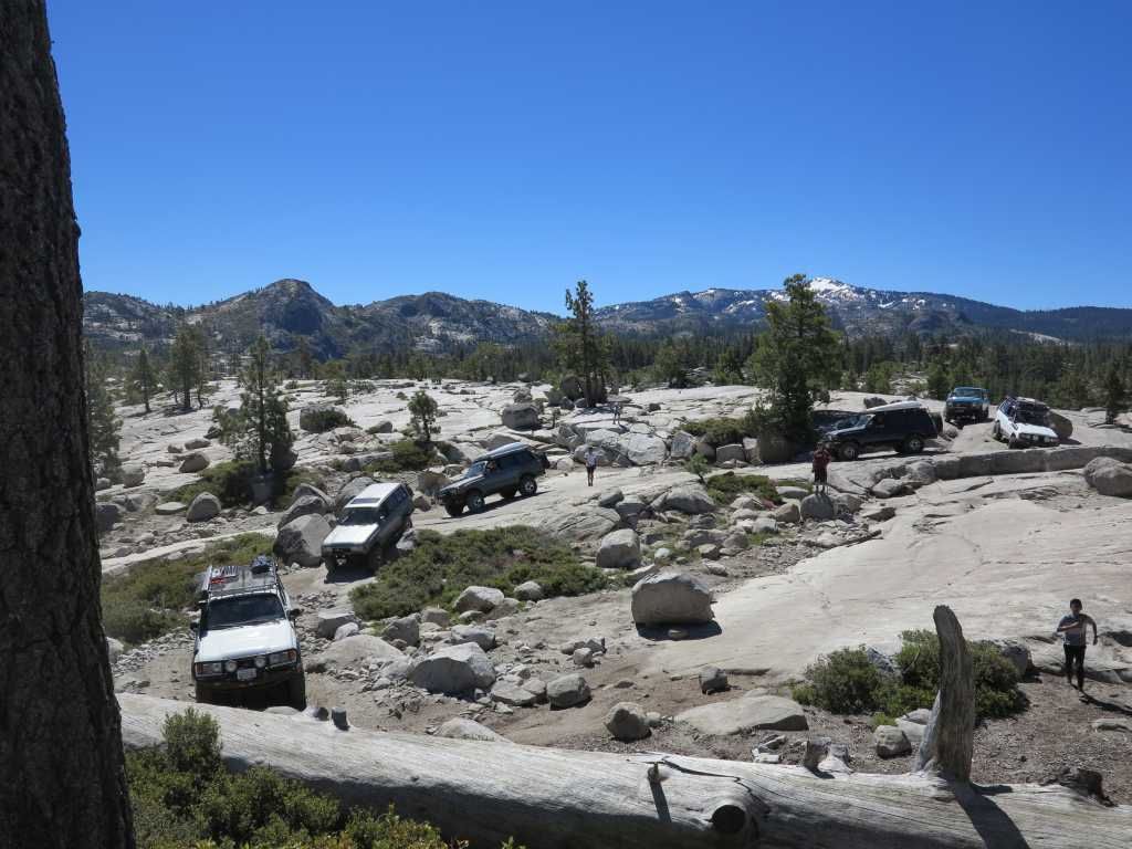

I took the LC on it's first trail run yesterday. The Ultimate Adventure guys were headed this way so I met them up at the Rubicon for a quick run in to see how things worked. Their rigs were all pretty cool, including a '73 Hilux on 40's and Verne Simons' Jeep pickup that I fell in love with. The Rubithon was also just getting started and I was able to jump in ahead of 30 other various Toyotas.
The truck worked flawlessly. Although there is still some work to be done, the only item I had to complain about was the rear fenders, tire contact was persistent. Eventually they will be cut.
Here are some pics. Enjoy.
