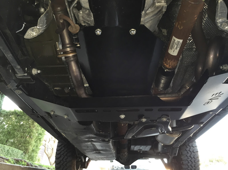

I ordered the Evo Protek Skid Plate system through NorthRidge4x4's Black Friday sale. It bolted up very easily and covers all the key vulnerable areas. It's amazing how much I've already scraped the bottom of the Jeep. The gas tank has several scratches and dents, and the transmission crash bar was severely gouged from high centering on a few ledges in Death Valley over Thanksgiving. Hopefully the Evo system will strengthen that Transfer case cross member.
