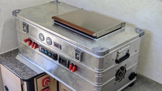

I travel full-time across these United States in a Four Wheel Campers Grandby pop-up truck camper, equipped with a Wallas Nordic DT diesel cooktop/heater (variable output: 3,000–6,400 BTU/h).
To estimate heating needs, you can use this basic formula:
BTU/h required = Volume (cu ft) × Delta T (°F) × K (heat loss factor)
  • Calculate the volume: Width × Height × Length in feet
    • In my Grandby, I approximate 6 ft wide × 6 ft high × 10 ft long = 360 cubic feet
    • I use 10 ft for length to account for the cabover overhang, which adds volume despite the base floor being ~8 ft
  • Determine Delta T (temperature difference): Desired indoor temperature minus expected lowest outdoor temperature
    • Example: 70°F inside minus 30°F outside = 40°F Delta T
    • Adjust higher (50–60°F) for colder climates or windier conditions
  • Apply the heat loss factor (K): This accounts for insulation and air infiltration (BTU/h per cu ft per °F). Typical values:
    • Tent (soft-walled): Poor insulation → K ≈ 0.45
    • Pop-up camper (like the Grandby): Moderate (hard roof/floor/base with canvas sides) → K ≈ 0.30
    • Hardsided camper: Better rigid insulation → K ≈ 0.15
For my pop-up: BTU/h = 360 × 40 × 0.30 = 4,320 BTU/h
In practice, during recent arctic blasts with sustained temps in the teens and twenties (°F), my Wallas Nordic DT performed acceptably on higher settings. It maintained comfortable interior temperatures. Results will vary with wind, sealing, occupants (body heat helps), and exact Delta T, but this setup has proven reliable for my full-time travel.
I hope this is helpful - feel free to share your own experiences!
