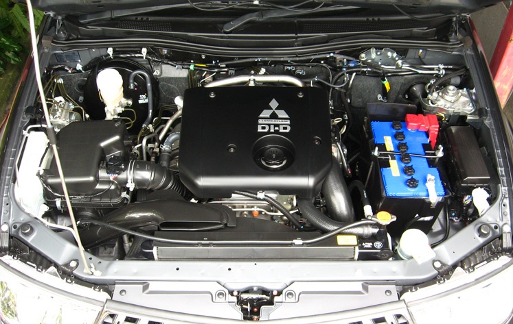

It's entirely possible that there is a dual battery configuration for cold weather diesel models.
Typically on a RHD vehicle, that space is there for the brake booster, steering linkage, etc. Possibly it was dual batt in a LHD diesel market. I haven't seen any Dual batt OE setups in the JDM Paj's I was looking at online before I decided to go with a "domestic import". Here's a typical 4M41 engine compartment (albeit shiny!)
