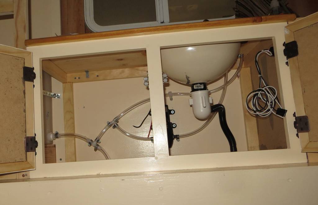

Got the tank Friday. Spent the day chasing parts and putting the water system together. I'll hook up the power tomorrow and test it for leaks.
Care to explain the plumbing?
Im lost :snorkel:
Tube coming out of tank to first Tee, which goes down to drain spigot, located under camper wing and up to second Tee which goes to electric pump inlet and to the manual pump port on faucet. The pump outlet goes to electric pump input on faucet. The faucet "Hand Pump and Water Fixture" is a 3-way allowing for hand pump, electric pump, and city water (which I haven't install). To operate the electric pump just pull up on the hand pump lever to actuate built in switch. I need to get a tank filter as shown in the schematic.
gatcha
I was worried about the line to the manual hand pump.
Thought it might have been a vent line. :sombrero:
Carry on!
