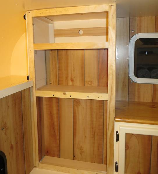

Worked on the water tank cabinet putting shelves in. There's a left over piece in back of the top shelf from when this was a coat closet. Couldn't remove it without damaging the wall.
I installed the tank vertical instead of horizontal so I'd have a space to store the camp table.
