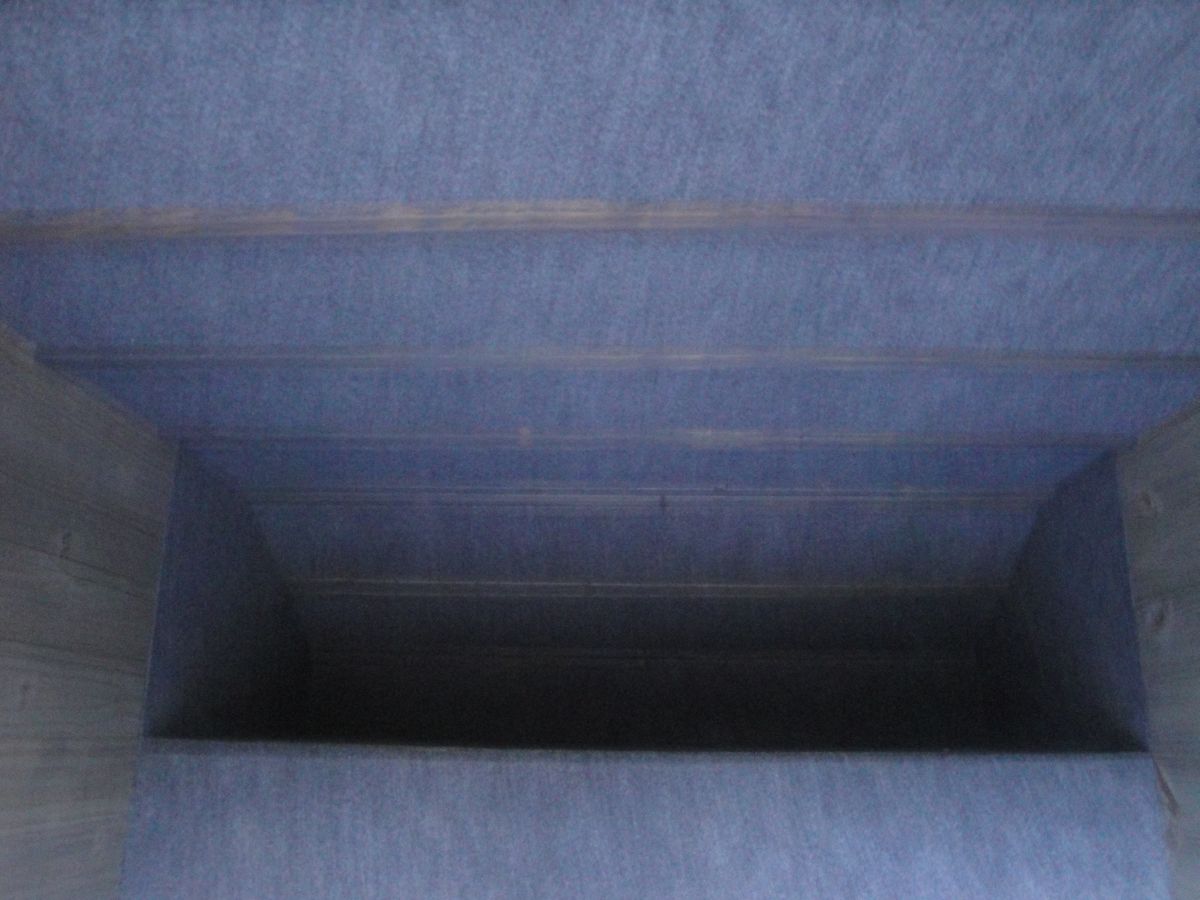

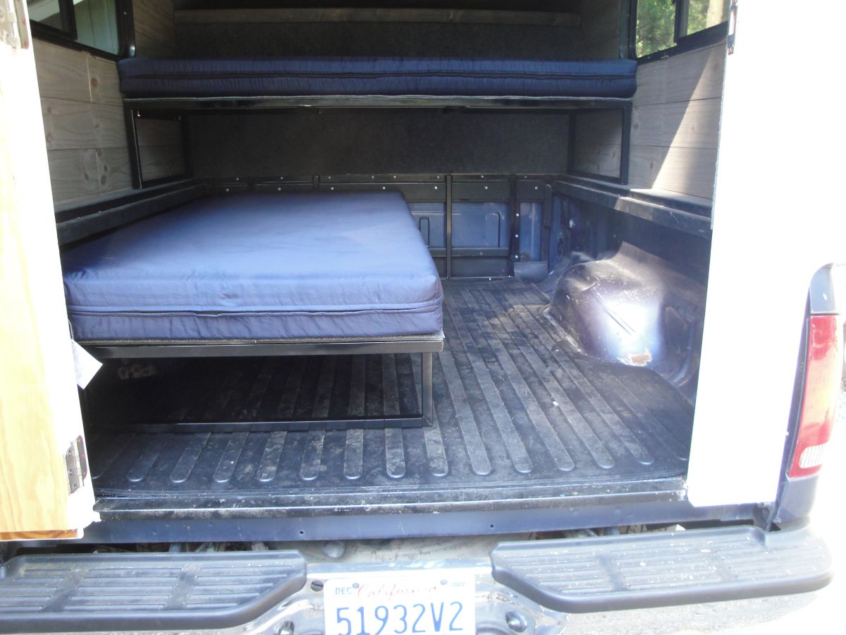

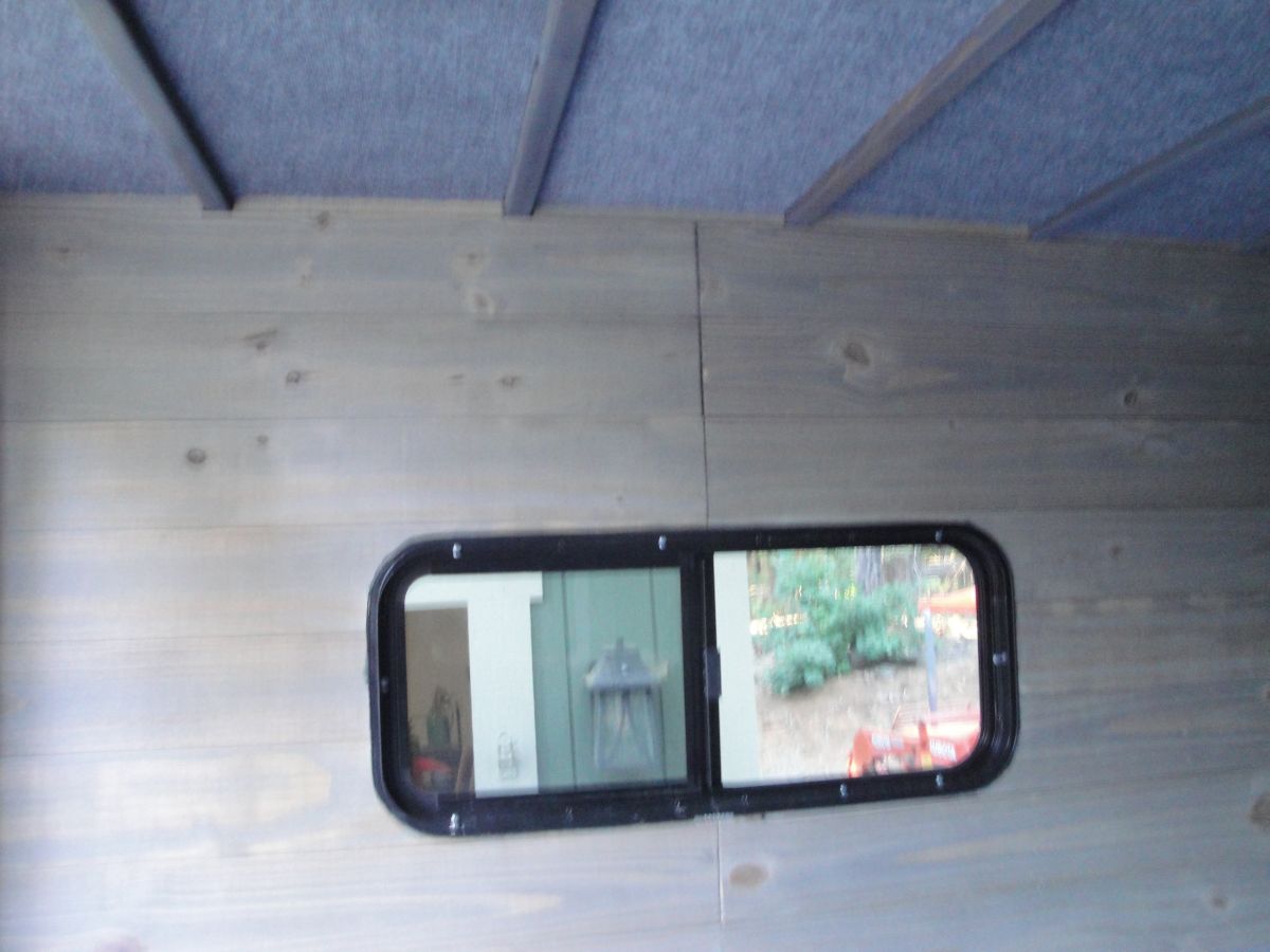

This was built by me last year. It is a perfect fit for a 1999 to 2016 Ford F250-F350 shortbed. I'm sure it could be modified to fit other Trucks with a similar sized bed.
Asking $ 3,600 for camper
Nevada City , California
Sean
the frame is 1" sq. tube with framework going down to the front and back of the bed floor to evenly distribute the weight.
The camper is framed with 1.5"x2.5" wood studs. The skin is .320 ac plywood. It is sealed with 2 coats marine grade epoxy resin.
Painted with 2 coats oil based enamel.
1.5" rigid insulation walls and ceiling.
48" wide door.
Bed frames are 1" sq. tube and easily removable, not bolted down.
Mattresses are high quality 5" foam and heavy duty covers from TruckMattress in Oregon. The upper mattress is 30x74. The lower is 34x80.
Interior dimensions are approx. 74" wide, 74" high,80" long with 48" cabover storage.
