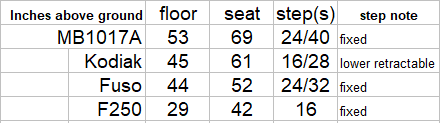

Here are some measurements I have taken on trucks I own/owned, with applicability to visibility * and accessibility.
*-visibility as to height above ground. Another factor for visibility in the long-nose vs. cabover debate is forward visibility to the ground, with the cabover having the edge over a long-nose and a short-nose (and sloped hood) like the Kodiak falling in between.
All on stock suspension (no lift or 'leveling' changes), F250 on 35", Fuso FG on 37", Kodiak on 42", MB1017A on 46"
Wow, you're a good foot+ higher in the Fuso and Kodiak. Coupled with no nose on the cabover obstructing your view of the ground, I can see why some folks love them so much.
