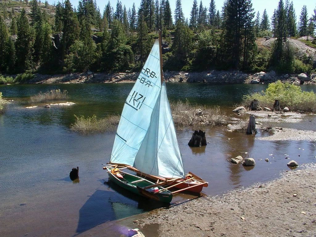

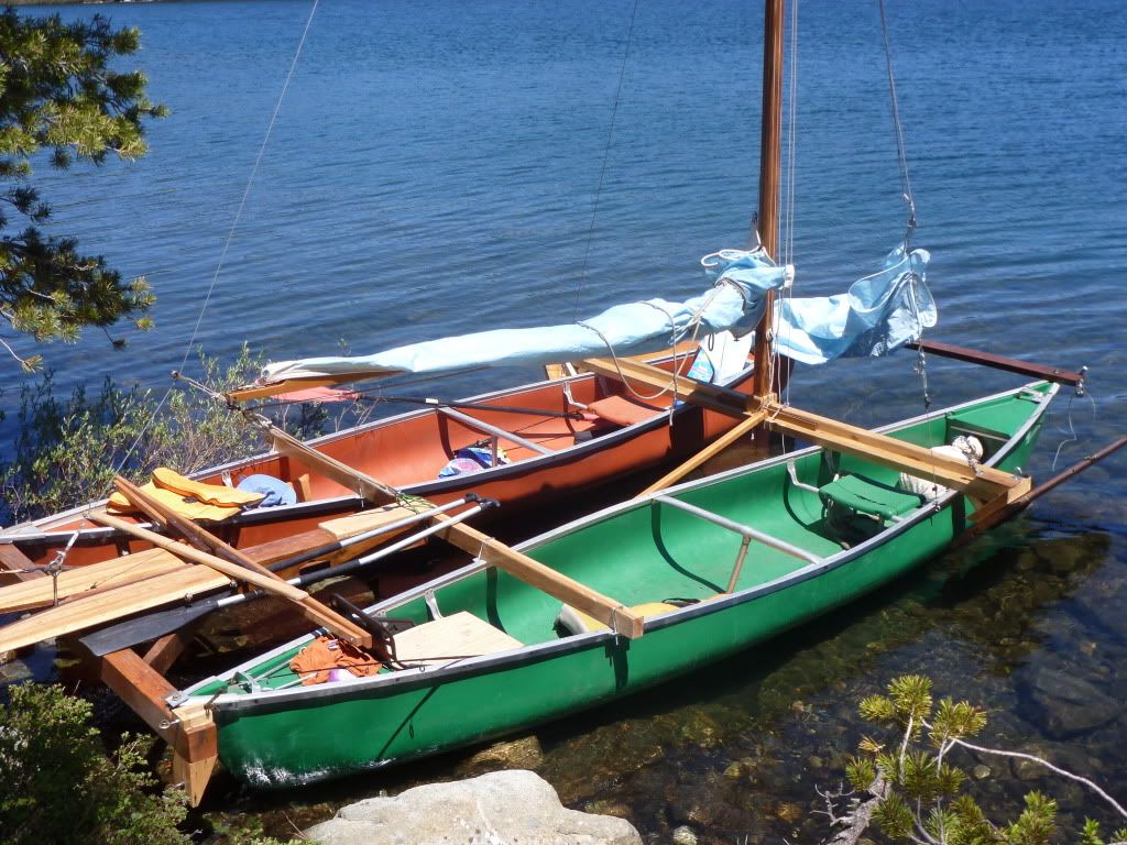

It just so happens...
Canoemaran 2.55.jpgA few years ago I was gifted a rig that fit this idea. It's from a Rhodes Bantam, a plywood boat from the sixties. While a conditional craft, she starts to foil at about 8 kts. forget about the deck a 90% of single handed paddling occurs through the center void...eat your Wheaties. The video and sails up pic are the 2.0 model The sails furled pic is the 2.5. 3.0 with a singular T-rudder is coming soon (been saying that a while now...)http://www.youtube.com/watch?v=s0xTZH3nYAw http://i1092.photobucket.com/albums/i406/Nufoiler/IMGP6194.jpg
http://i1092.photobucket.com/albums/i406/Nufoiler/P1000468.jpg

HMMM...this is good info...I like that last pic...just throw a 15 horse between the boats and go...
