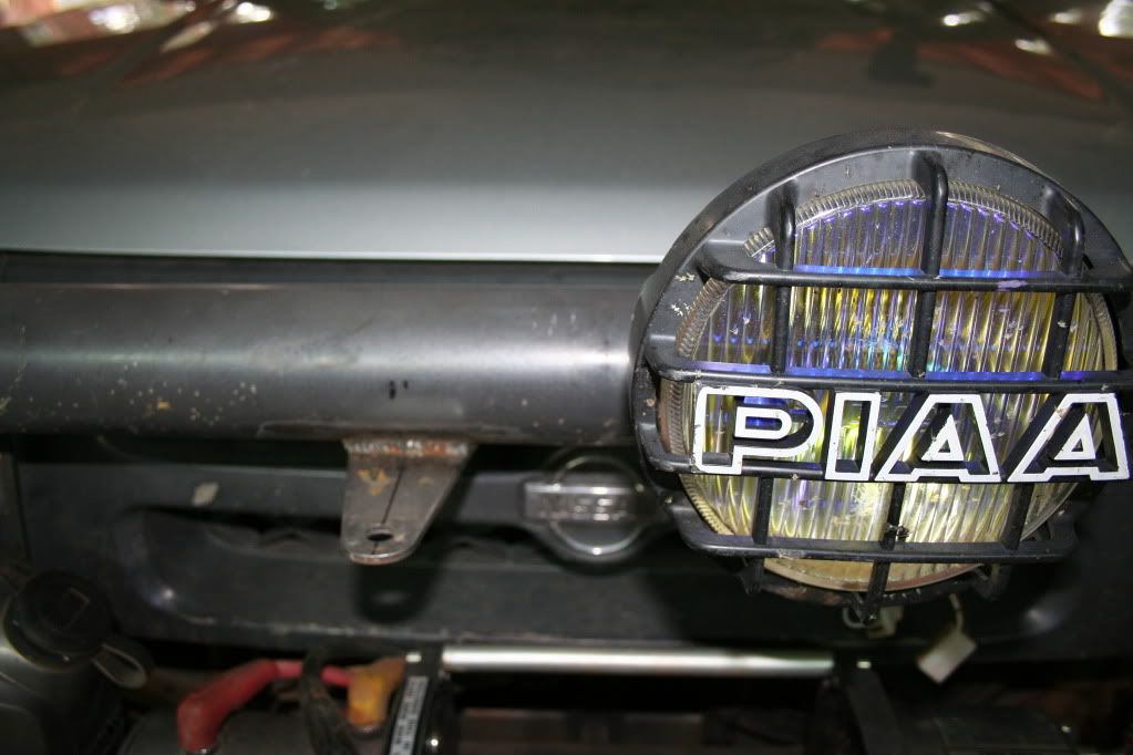

Here is the Calmini front bumper in it’s first faze.

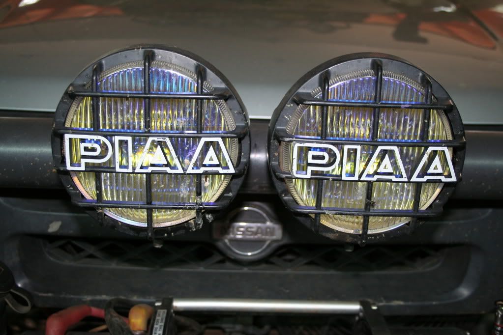

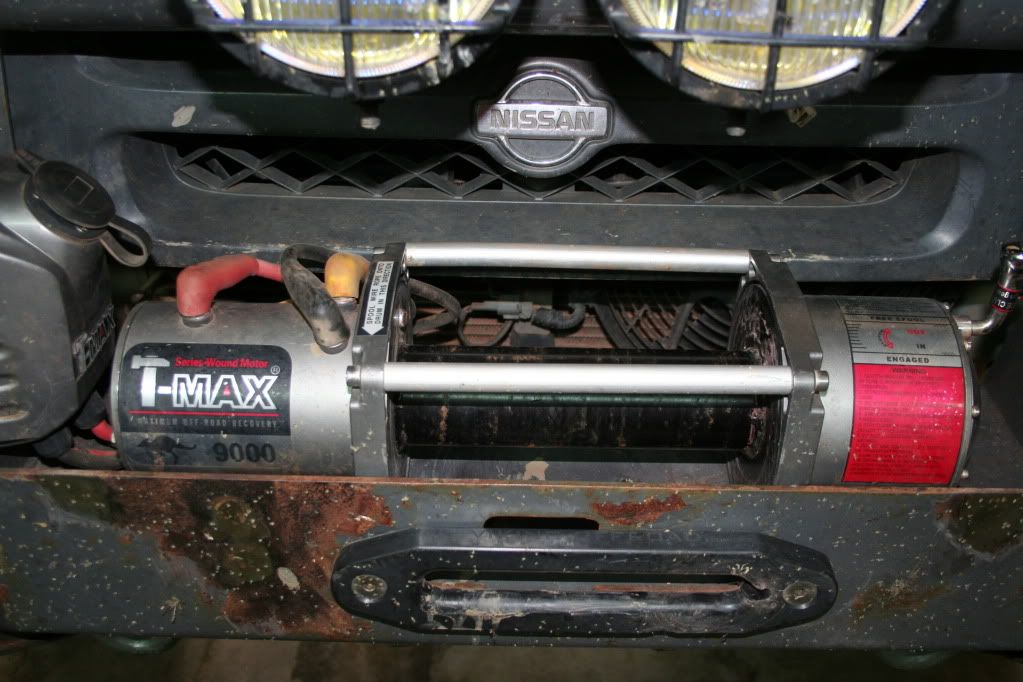

I mounted a set of PIAA Ion Crystal fog lights and an old Warn winch I had from a previous truck. This setup worked well for a few years. I then upgraded the winch to a T-MAX 9000lbs with synthetic line.
The line is off in this photo because I am in the process of removing the bumper to paint it, too much rust. I will be painting it with Duplicolor Spray on Bedliner. Once it’s done I will post more photos. I also decided to move the lights as they were in the way if I came up to push something.
I had some tabs welded on to the top tube to get them out of the way. Lastly I am sure someone noticed the big holes in the bumper and skid.

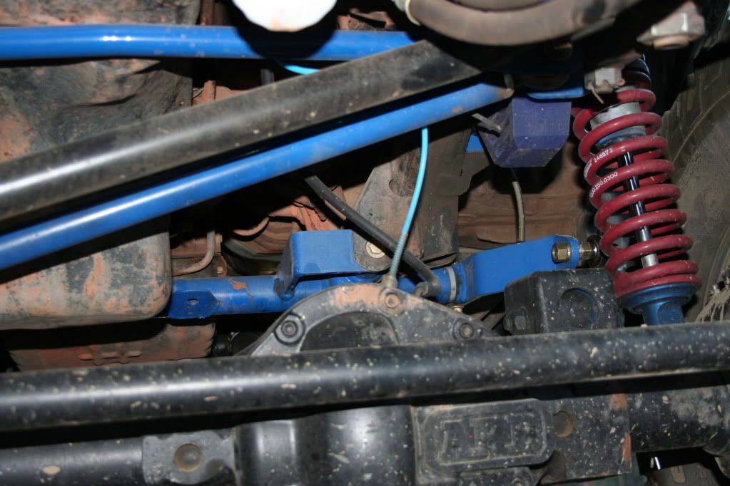

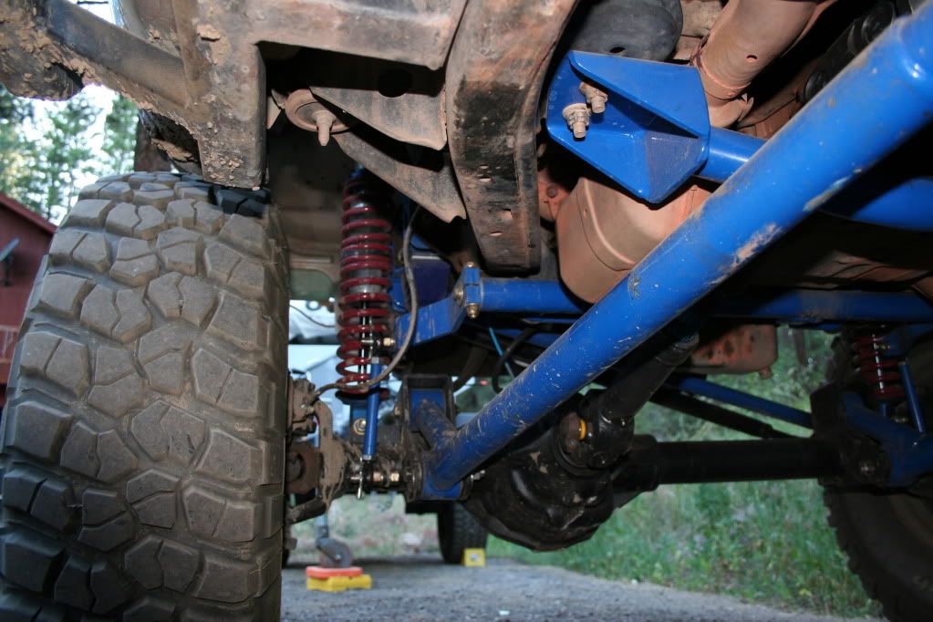

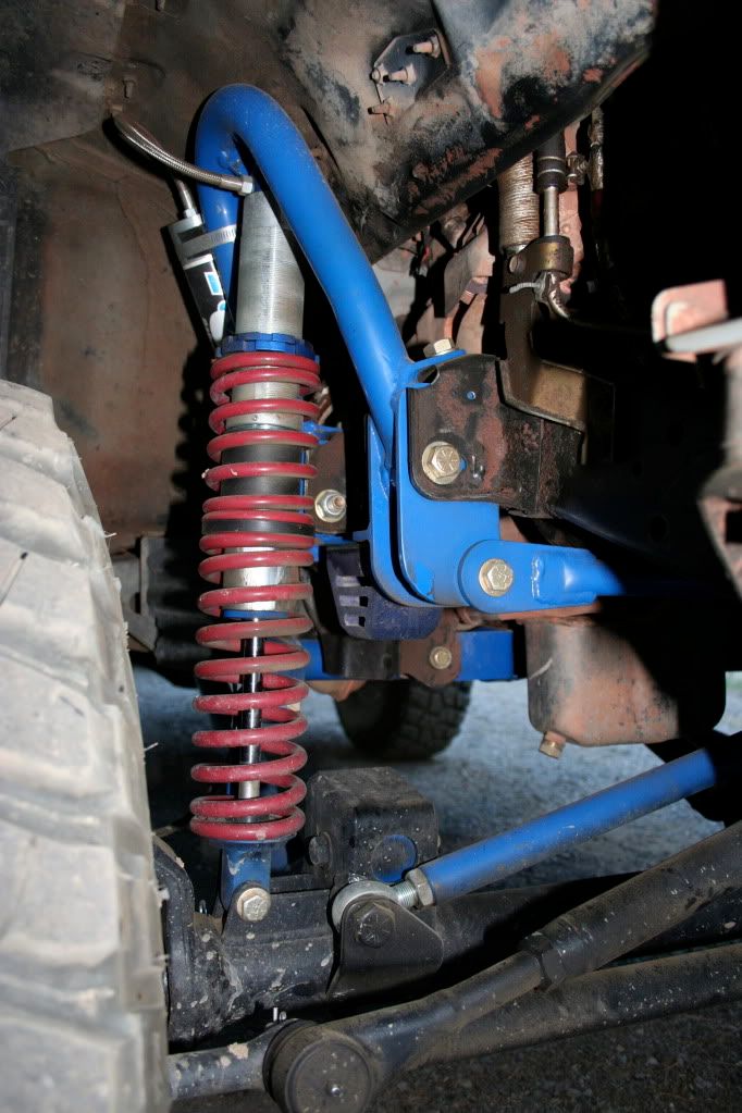

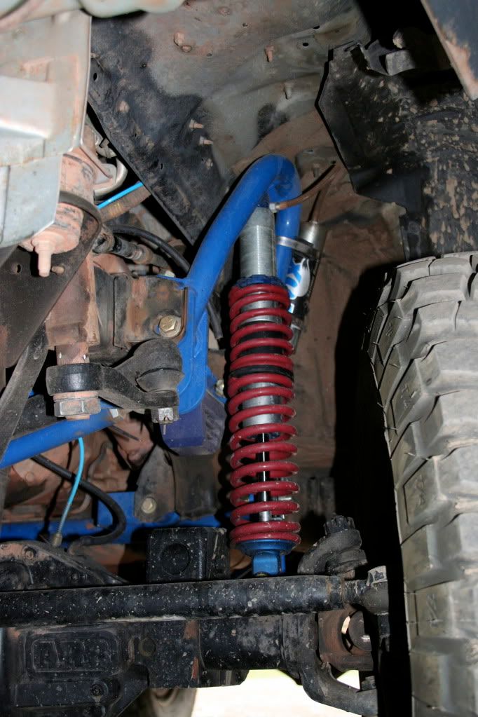

I have been running the Calmini 3 inch kit for quite a few years. I have been happy with it, for an IFS setup, but it was time to step it up a notch. This winter I bit the bullet and installed the Calmini SAS kit.
I have to say this is one heck of a kit. Very well thought out and designed. Easy to install. It uses a D44 out of an 80 to 85 Jeep Wagoneer. I started the build with the goal of running a 35-inch tire without a body lift. With that in mind I had to beef up a few things. Steering was the first. The kit is designed to use the stock Waggy steering.
I tossed that and got some 1-ton Chevy tierod ends. This is coupled with 1 ½ DOM tubing with weld in bungs.
Next upgrade was the track bar mount on the axle. It was single sheer. A small gusset fixed that.
(Bugger, I am missing that photo, I will take another and add it later)
That’s about it. The last upgrade I did because I thought it needed it. The swaybar that comes with the kit bolts on.

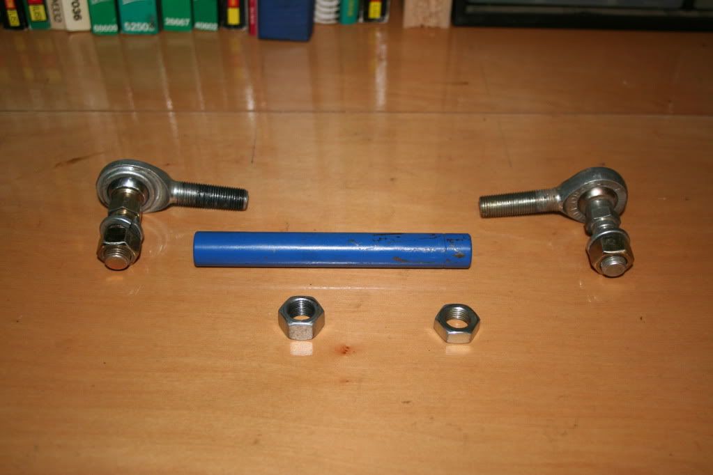

This is fine if you don’t want to be able to remove them for better articulation, I wanted to do just that. So I purchase a few Hiem joints, some 1/2 inch bolts nuts and some 1/8 inch quick pins.
Casper
Casper
Then I just rounded the heads of the bolts off, drilled a hole in each one for the pin and bolted them in place.
Vala, quick disconnect sway bar ends.

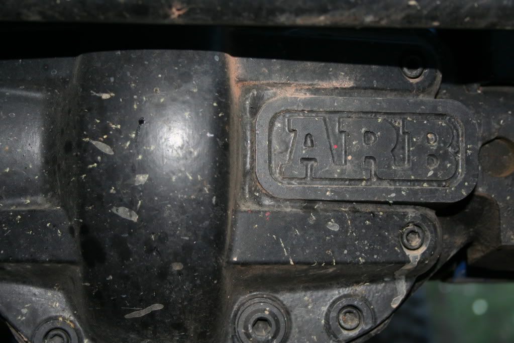

The axle is geared with 5.13's and has an ARB locker.

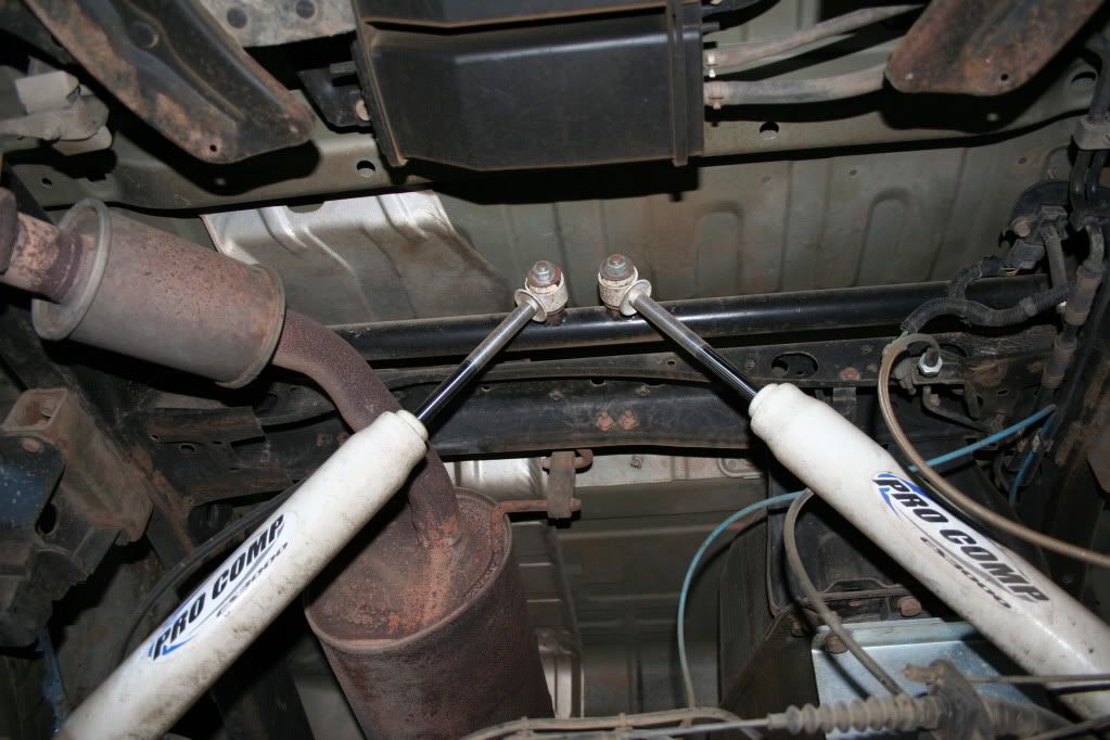

The rear was next. For this I just did a simple SOA.
I still have the Calmini 3 inch lift setup with this. Eventually I will be getting a set of Alcan springs. I also moved my rear shock mounts last year. The stock ones got ripped off one to many times. The tops of the shocks are mounted in the center of the vehicle to a custom made tubular cross member.
The bottoms of the shocks are mounted to the top of the axle tube. This setup makes for great articulation, but you give up a little rear stability. Not much, but you do notice it. The rear also has an ARB and 5.13 gears.
This setup works great. I have some very minor trimming to do at the back of the front wheel, but that's it.

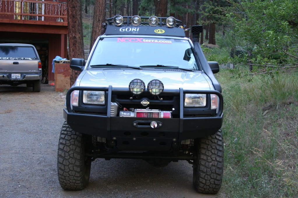

A few more updates from this last weekend. As I am sure some of you noticed, my front bumper looked like c@@@. Very rusty. Well, I spent the weekend fixing that.
Took it and the grill off, completly sanded them down and sprayed them with Duplicolor spray on bedliner. I think they came out good, but I should have practiced spraying it more, some parts came out smooth and some parts had a ton of textcher to them. Overall I like it.
Now a few photos of a semi clean X.
