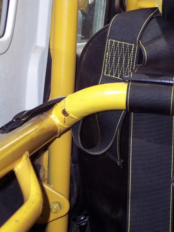

The more I have used the jeep, the more I aware I became of the fact that there's usually only two of us in it on most trails. Behind the front seats, I have my harness bar. This bar is removable to aid in passengers accessing the rear seat (The bar has never been removed). The rear bar however never had this feature.

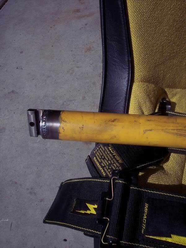

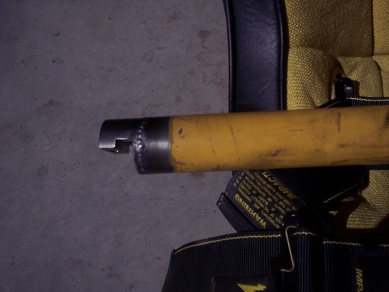

I asked my friend Sam, owner of Samco Fabrication in Reno to assist me with adding this feature to the rear harness bar. One day later, voila! Here's how she looks now (I apologise for no before photographs, my head was hua).
The first pic shows the front harness bar in place with the quick disconnects (This bar has never been removed. If you wanted to, all you would have to do is remove the four allen head bolts). If the bar is removed your shoulder harnesses would be removed also leaving the lap and anti-sub belts in place.
Here's the rear harness bar removed with a close up of the coupler (Man that bar is dirty!) These are pre-paint as you can tell.
Here is the cage side.

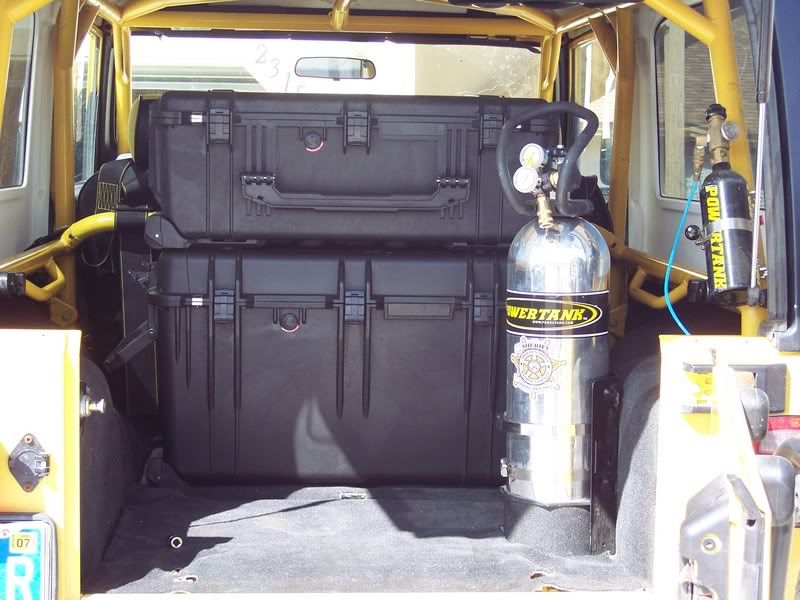

And here's a look loaded with Pelican cases (1660 on bottom 1650 on top)
Finally cases, ARB fridge and Powertank mounted. The small rollcage mounted bottle is dedicated for lockers and the polished tank is for tires and tools. I'll probably switch to a 10 lb. tank and mount it on the drivers side roll cage.
I really like how it turned out. It's now a lot easier to access the rear area.

Thanks for the compliments guys. The stock cage was removed and we started over fresh. I went with co2 because I was ignorant. I wanted less moving parts to fail. I had the chance to be one of the first non-comp guys to get this setup (The Jet-pack), so I did. I have an extra bottle in case one runs empty while out (I have not run both tanks empty yet. I have however thought one was filled and it was not). I can also fill the jet pack tanks from the larger one, although I haven't done it yet.
I thought I would be doing mainly rockcrawling. Well you can only deal with the b.s. for so long. Now the idea of extended overland trips away from the crowds seems to be the path I'm headed down.
I will be adding an oba setup in the future. I just have to decide if I want it vehicle mounted or removable from rig to rig. It's just one less thing to worry about (The need to have your tanks filled before you head out). Also one consideration, the cost to fill the 15lb tank is around $35.00-40.00 in reno. It started out at $15.00 and they did it while you waited. Now, you have to leave your tank overnight, which is another source of worry.
