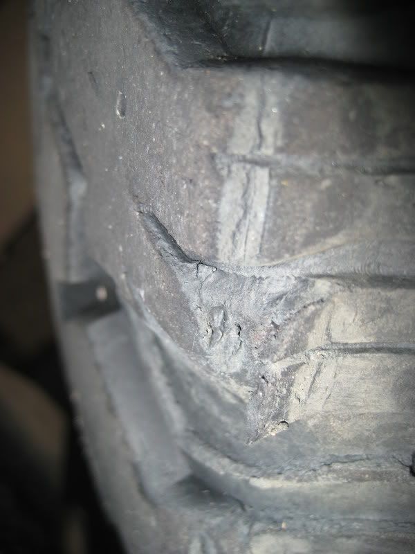

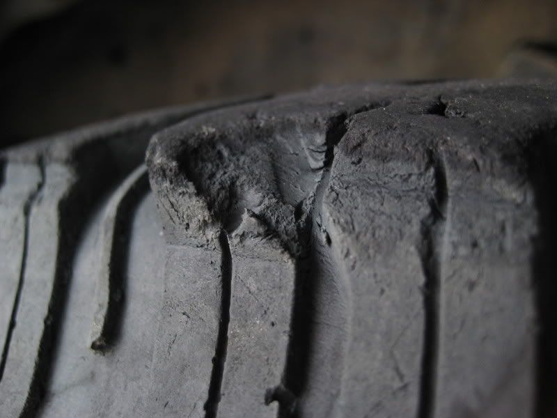

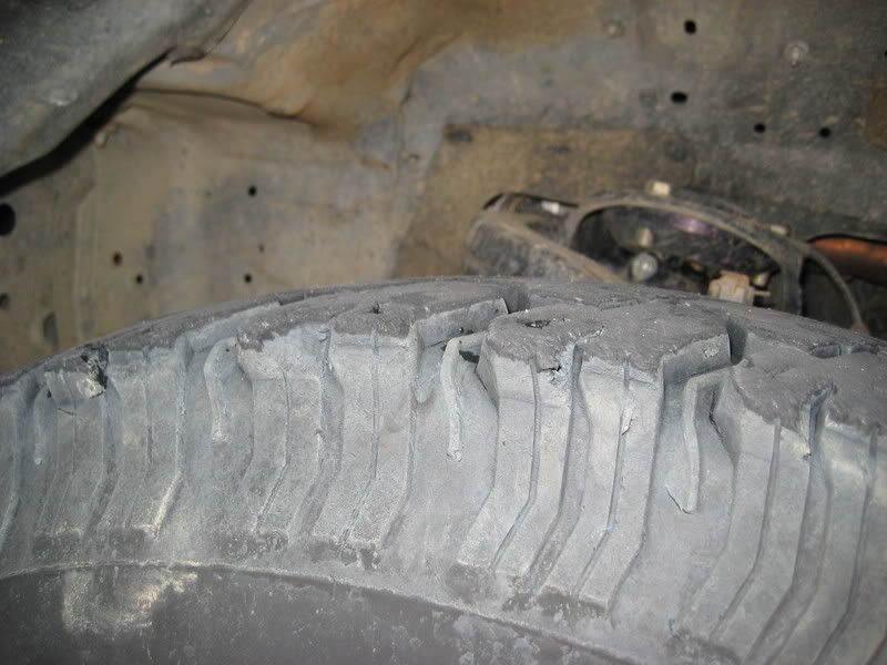

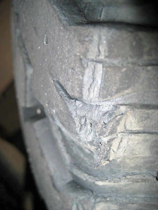

to be a little more accurate. I have about 20k miles on these. Check out the chunkiness. Good tread depth still... st-c maybe nex time,but I hate getting 285's
Still love them though.
Those are some pretty good chips/chunks there SoAz.
I agree, going to 285s to get the ST-C doesn't sound appealing to me either. A couple weeks ago I was thinking that 285s might be nice (didn't realize the ST-C were available in that size), and surely would look good. But I talked myself out of both another set of tires and 285s. At least for now.
Thanks for posting this, I'll have to keep an eye on mine to see how they hold up.
Cheers,
P
Excessive chunking was one of the big complaints I read about on some Australian forums but I still decided to buy these.
I wonder how much the soft/sticky tread compound is contributing to the chunking people are seeing?
Edit:I have learned that chip resistant tires are softer, harder tires are more susceptible to cutting/chipping.
I have a feeling that has a lot to do with it. These tires are softer to the touch than any I've ever owner. The amazing part is that the tread depth is really great still. They seem like they will last for a long time as long as the chunking doesn't get too excessive.
p1michaud,
You're welcome. Most of the chunking seems to come from these sharp az rocks. :truck:

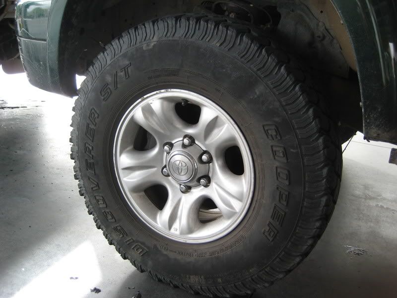

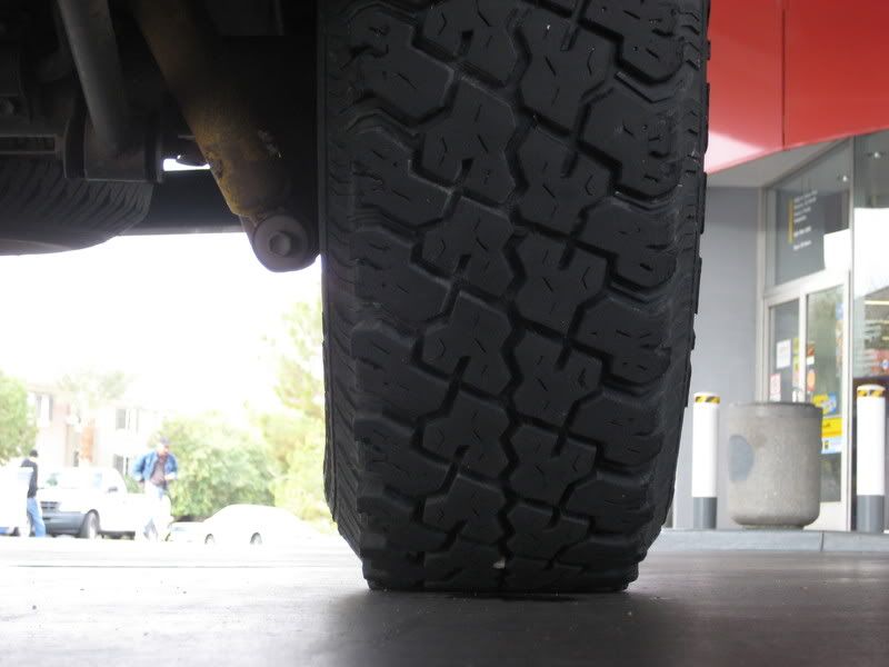

Adding to the info in this thread, here are a couple shots of the supper narrow Cooper STs stacked next to Maxxis Bighorn MT. Both tires are 255/85R16 and both are mounted on Toyota TRD 16x7.5-inch wheels.
The Coopers are noticeably narrower, but mostly in the tread. The Cooper ST has a tread of about 7.2-inches while the Bighorns have about 7.75-inches of thread width. I like them both ☺ The Coopers were temporarily removed to run the quiet Maxxis Bravo ATs.
