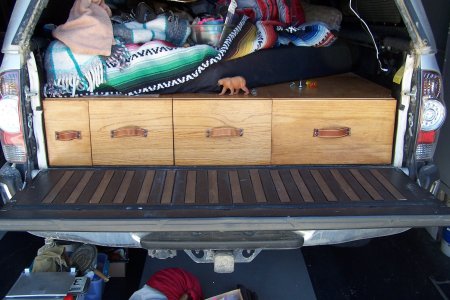

Anybody cut hole in bed and behind seat panel to make long sleep area in Gen 2? Currently sleep diagonally above drawers,
not ideal but works. Thinking remove back seat then cut back firewall below window that extends down to bed Crazy right? I know it would need to be sealed to keep water and dust out. Would 2' x 1' hole effect body rigidly that much. Wondering if anyone has done it without twisting truck body like pretzel. Saw the concept Slate truck had back panel that dropped down to hold full sheet of plywood. sunny SoCal100_0709.JPG

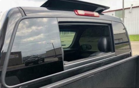

A slight change to that idea would be just going to a glass shop and having a custom window for the back of your cab made that had that approximate 2’ x 1’ opening that you mentioned. That might even be something you could configure yourself.

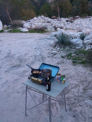

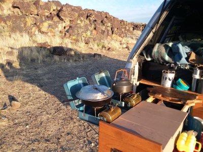

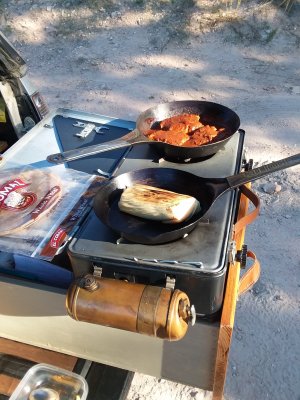

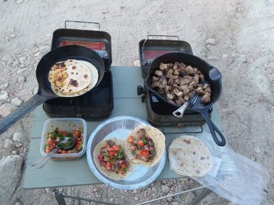

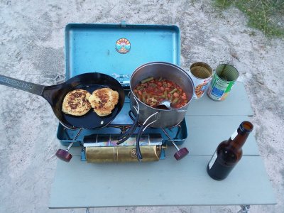

On a different topic, you seem to have a collection of nice stoves!
What's the 2 burner one? Would you have more pictures or information?
sorry of this derails your thread.
