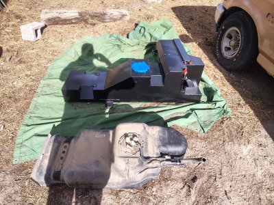

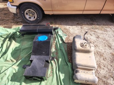

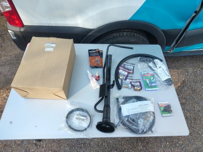

The Factory Tank in the D40 with the VQ40DE is 80 Liters/21.125 Gallons. The Tank I'm mentioning is 155 Liters/40.95 Gallons. It is made by Outback Accessories Australia and the part number is FTN52. It requires a different Fuel Pump assembly with gasket and a Fuel Filler Neck due to differences of the US Built and Spanish Built D40(don't ask me why when they both have the VQ40DE available).

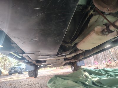

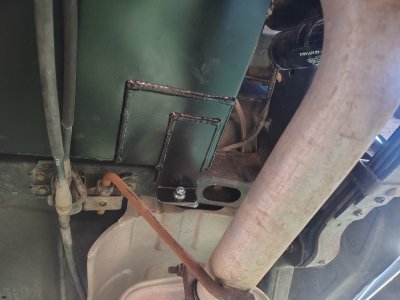

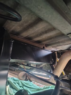

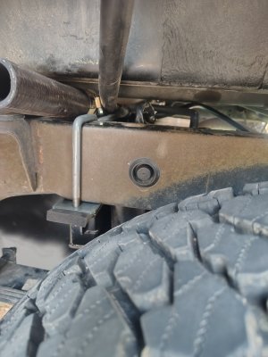

The installation isn't too bad, it I highly recommend having an extra set of hand if you can. If you have a two post lift with transmission jack, that's even better. Just know that it is a tight fit.
Clearance underneath is about the same as Factory. Unless you are on the wrong trail or not paying attention, you won't have to worry about hitting the tank on the trail.
