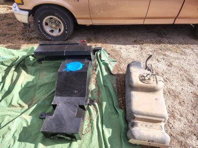

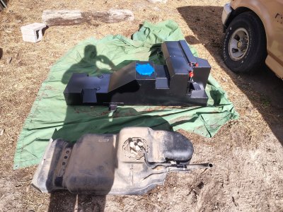

Well if anything I figured I'd give a little tease of the fuel tank. As of today I have the old tanks out with all the prep work done and the new tank is ready to go in(and will hopefully be completed tomorrow). As a reminder the Factory Tank is 80 Liters or 21.125 Gallons and the New Tank is 155 Liters or 40.95 Gallons. Clearly you can see the difference in size and there is just enough room for it to fit.
Once it is complete, I will post it up on another thread.
