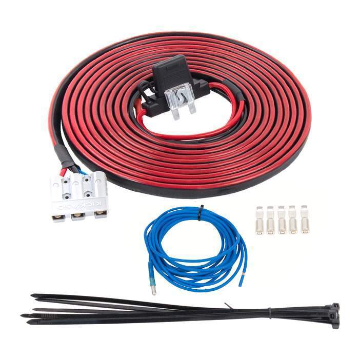

I am working on buying my first trailer and have not settled on one yet. I do know I would like the backup of having dc to sc charging when traveling. Assuming the unit has a dc to dc unit like the redark does it matter what size Anderson and fuse I use?
I saw this product which was a 50akp Anderson plug and 80 amp breaker. Does that matter what’s on the trailer at that point or am I safe to wire this in to my pickup.

That kit is a fire hazard. The 80A fuse is way to big to protect 40' (combined length of pos and neg) of 8ga wire.
40' of 8ga should carry 10 amps and be protected with a 15amp fuse/breaker
