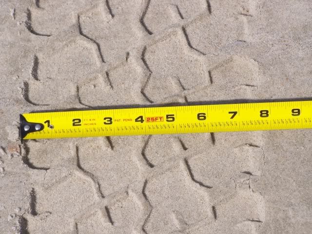

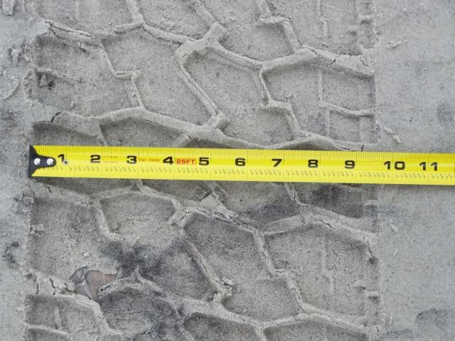

Here's some tread pattern shots from our Core Banks adventure. Where better to check on tire void but in the damp sand of an ocean beech.
First up...the Dean SXTs. Size 285/75/16; tire pressure at 22 lbs
Next...Cooper Sts. Size 255/85/16; tire pressure at 20lbs.
The Deans preform very well in the sand and I had to blast through some deep wet stuff at one point as the tide was right up to the dunes. A Tacoma had been stuck in the same spot, moments before but the Deans rolled on through without any wheelspin. The I-force V8 might have helped some there to...:sombrero:

At those pressures the tire footprints don't look much wider than normal (a 285/75R16 is usually about 9+ inches wide at the tread).
Just an observation, not being negative or critical. Depending on the weight of the truck, 22 psi is not super low, but I'm sure it was low enough to let the tire flex for better traction.
Yep, your right. But both trucks were loaded to the gills and carring some weight so I didn't feel to comfortable dropping them down to 15 lbs.
