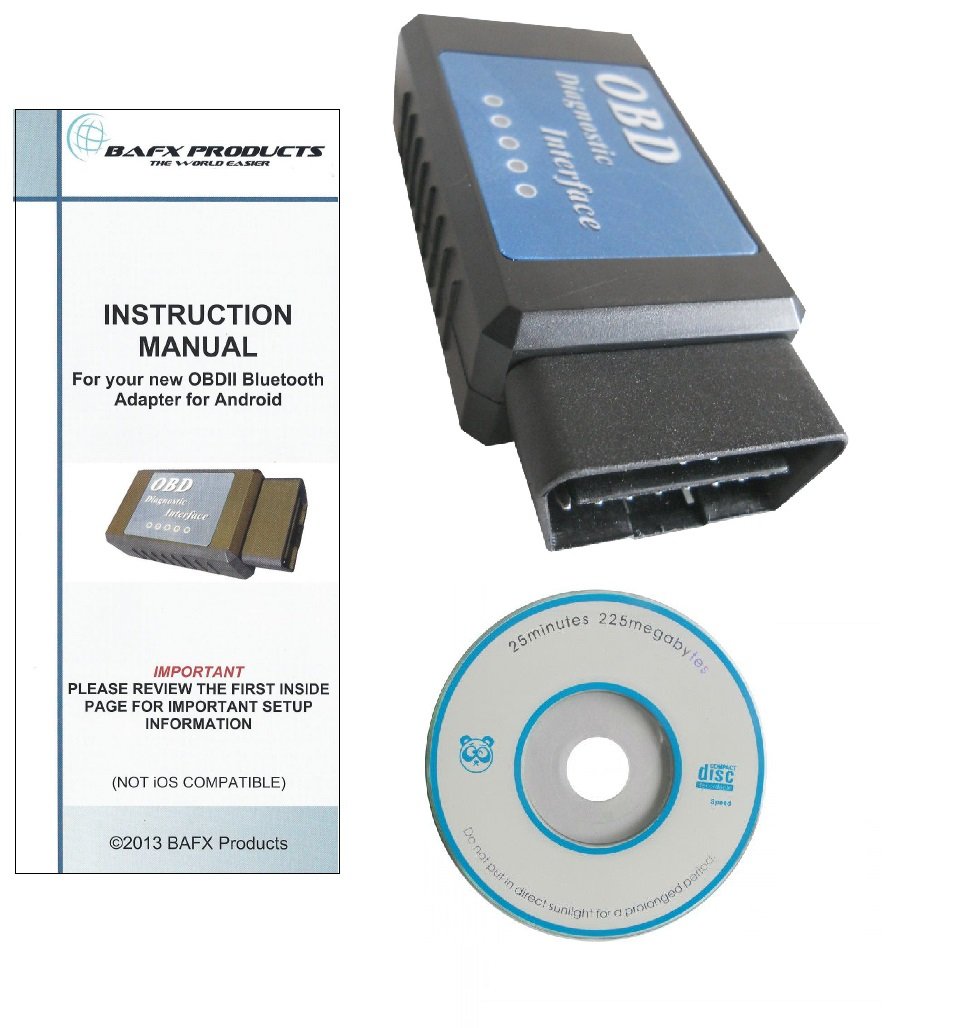

What brand / model is that? I know theres a few people searching for a working dongle.
http://smile.amazon.com/gp/product/B005NLQAHS
I use the "Torque" application (android) to talk to it.
