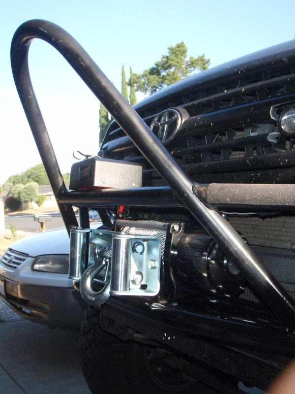

Current bumper has been modified and enhanced to mount the XRC10 winch. Winch is mounted but not wired. Still need to paint the winch plate and added metal. Here's some pics from my blackberry. I'll have better pics during the day. After these pics were taken, additional tabs were welded for the roller fairlead. The winch plate has been welded to the frame cross member and the two crossbars of the bumper. The lever to engage and disgage the winch was also modified for clearence.
Thanks to Adam and Orlando of AnySevenOffRoad in San Leandro, CA!!!!
Finally rattle canned all the exposed metal, wired it up. Only thing left to do is attach the +/- cables to the battery. Need to get some new terminals for the top of the optima. Here's pretty much the final pics:

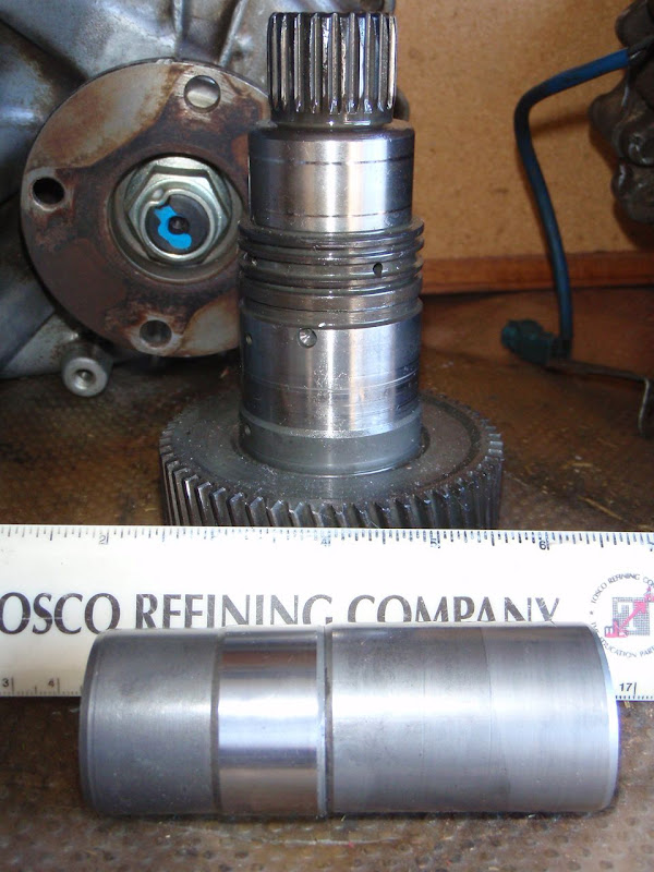

Either case is the same case the tundra uses but, with some differences. I also removed the input shaft coupler. This is what determines manual or auto tranny application. The shorter one is for an auto and the taller one is for a manual tranny. I had an extra input shaft and I pulled the coupler off of that. At this point I'm pretty much set and ready for the swap. Here are some pics. Xfer case on the right is the one I had to fix and with the bad shifter. The left is the one I got yesterday all nice and clean. :D. Both are J-shift type of xfer cases and both are at the 4LO position. Tool on the left is a bearing puller I used for the couplers.

Bearing puller tool I used to separate the coupler from the input shaft.
Tundra auto coupler left, taco auto coupler right.
