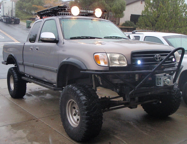

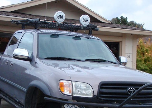

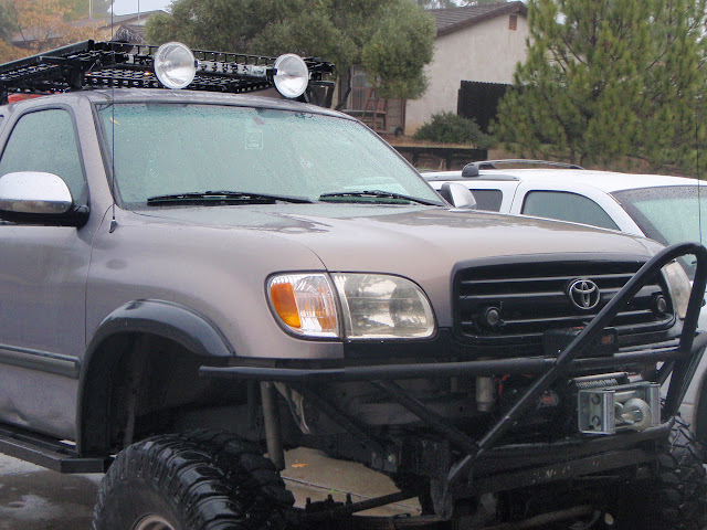

Pic update... Remounted my Hella 700's up top. However, I mounted them so they don't stick up higher than the basket.
Before:
After:
That looks better..more streamlined and less bunny ears. :elkgrin:
Exactly the reason I took them down in the first place... LOL!
