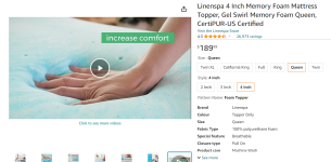

I hear you on the factory supplied mattresses. We ended up getting this mattress topper for ours:
Yup, the cargo conversion was sold in the fall.
I looked at various toppers, including that one, but ultimately decided that we will get a new mattress altogether. Currently planning on picking up a 60x80 (residential queen) Juno mattress from https://www.juno.ca. That mattress will be 8" thick, which is about the maximum thickness we can get that'll still allow a hand to reach to the "nightstand" areas. Mattress reviews are largely positive, but of course that's very subjective. Juno seems to have a long and easy return policy (should it really come to that), but I'm hopeful it'll be a comfortable mattress and will work well for us.
