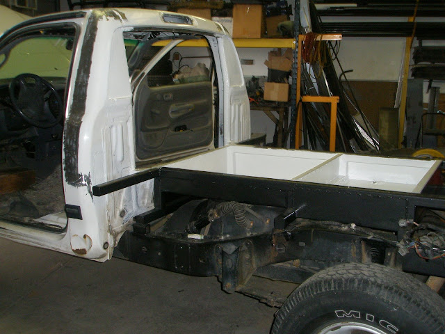

To finish the work on the basement and bottom of the camper, I took the camper off and flipped it upside down. I replaced the floor in the mudroom with new 3/4 inch birch plywood. I re-fiberglassed everything and bedlined it.

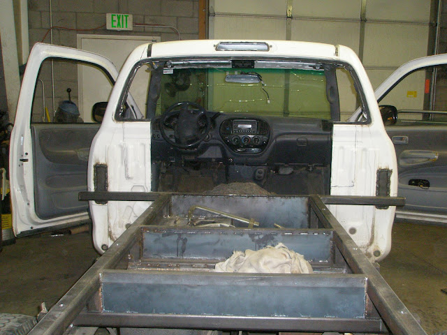

While the camper was off, I finished building the subframe for the rear winch. I boxed the frame rails and cut off the original cross member for the spare tire, which made just enough room for the second gas tank.

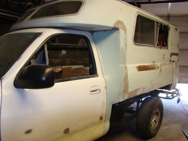

I cut the cab back wall for the walk through. I reinforced it with 2 inch. DOM tubes.
I also finished the fiberglass work on the camper and attached it to the cab. I tried to make a smooth transition on the sides between the camper and the cab.
I started to fix all the dents and did all the body work. The side moldings were removed as well. Now I'm going to prepare it to get painted.
DSC06698.
After the camper was attached, I also cut the roof to make the walk-through more comfortable.
